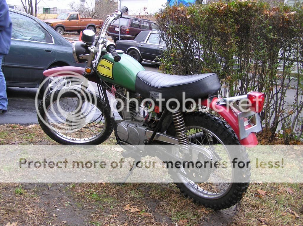

Well I don't know that I can help you, but I do know how you feel. I just got my '72 SL100K2 (tortoise green-not my favorite color) this past weekend. I've been looking on Ebay for the parts I need. Lower triple clamp (steering lock tabs are broken), original type handle bars (some funky bars on right now) and the engine has a serious cam chain rattle. I have a Clymer repair manual on order and I found complete triple clamp on Ebay. It seems like everything you are looking for is reproduced from China. That's what I have found for the handlebars so far. Good luck with your restoration.

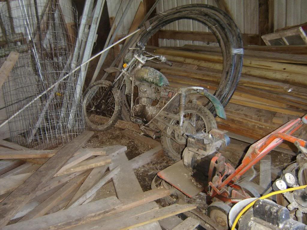

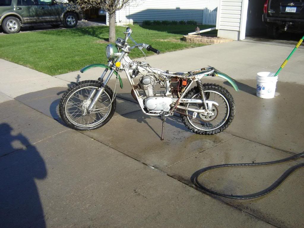

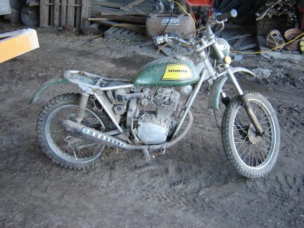

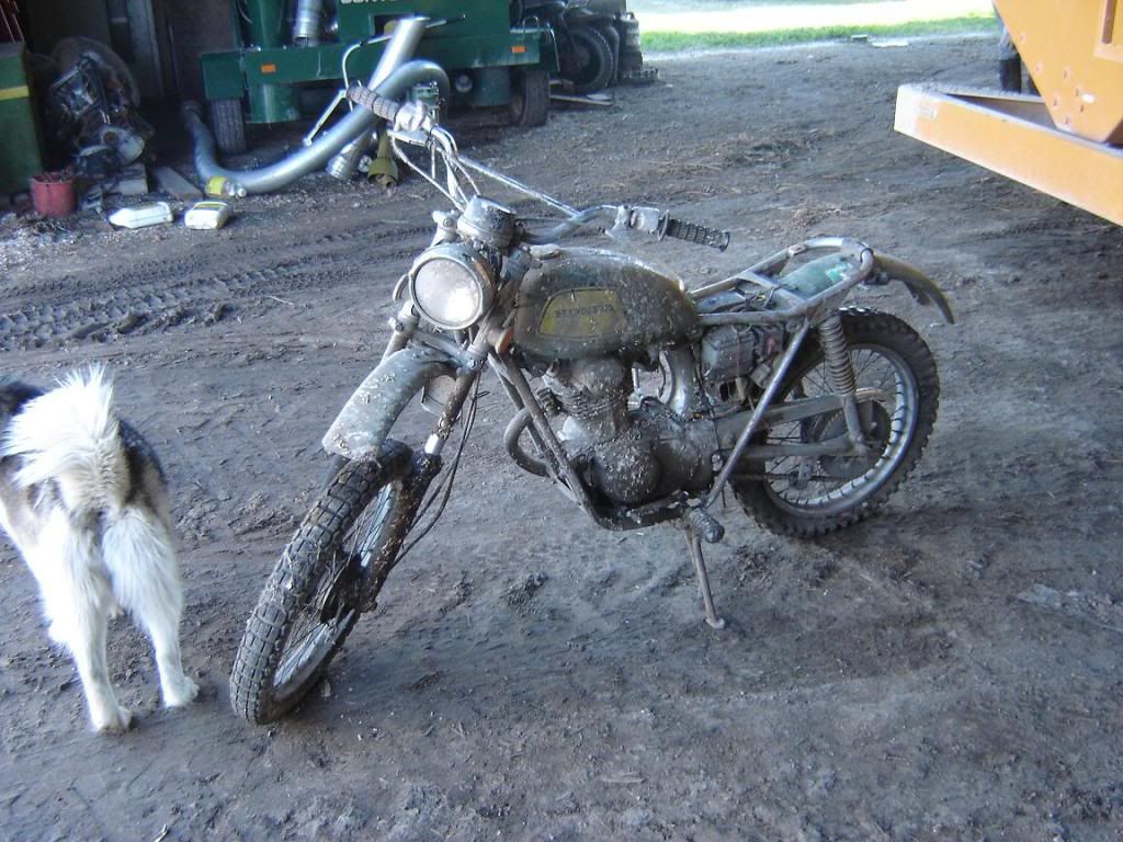

This bike was a Christmas present to me in the early 90's from my parrents.  The had gone to a guy's farm to pick up a minature horse for my sister for Christmas and my dad noticed this bike sitting in the barn so he got it thrown in on the deal with the horse!  It didn't run but I think that made it even better because I loved to fix things.  I cleaned the carb, filed the points, put a new battery and fresh gas in it and had it going the next day riding it around in the snow.  The best part of the deal is that I have the title for it.  The signed title that I have is dated 1974!
I was able to get home to the farm last weekend with the trailer and dug this jewel out of the machine shed!

That is a jewel for sure. Amazing you still have the same bike.
I had the exact same machine in red as a young teenager. Unfortunately I eventually killed it through years of abuse and lack of maintenance and the remains were sold off when I was 18.
I found an identical bike last year that was in about the same shape as yours when I got it. I decided to make a playbike/vintage motocrosser out of it. I did a little TLC, added some paint and number plates and it looked great. Then I did what you did - filed the points, cleaned the carb and put in a new battery - and it fired on the first kick. With a little fiddling it ran perfect. In a week I was doing giving full MX 250s fits without even changing the stock tires (the photo below). This was a bike advertised as a non runner that had been sitting for years...
The old SL100s are amazing bikes. The motors in particular were ahead of their time.

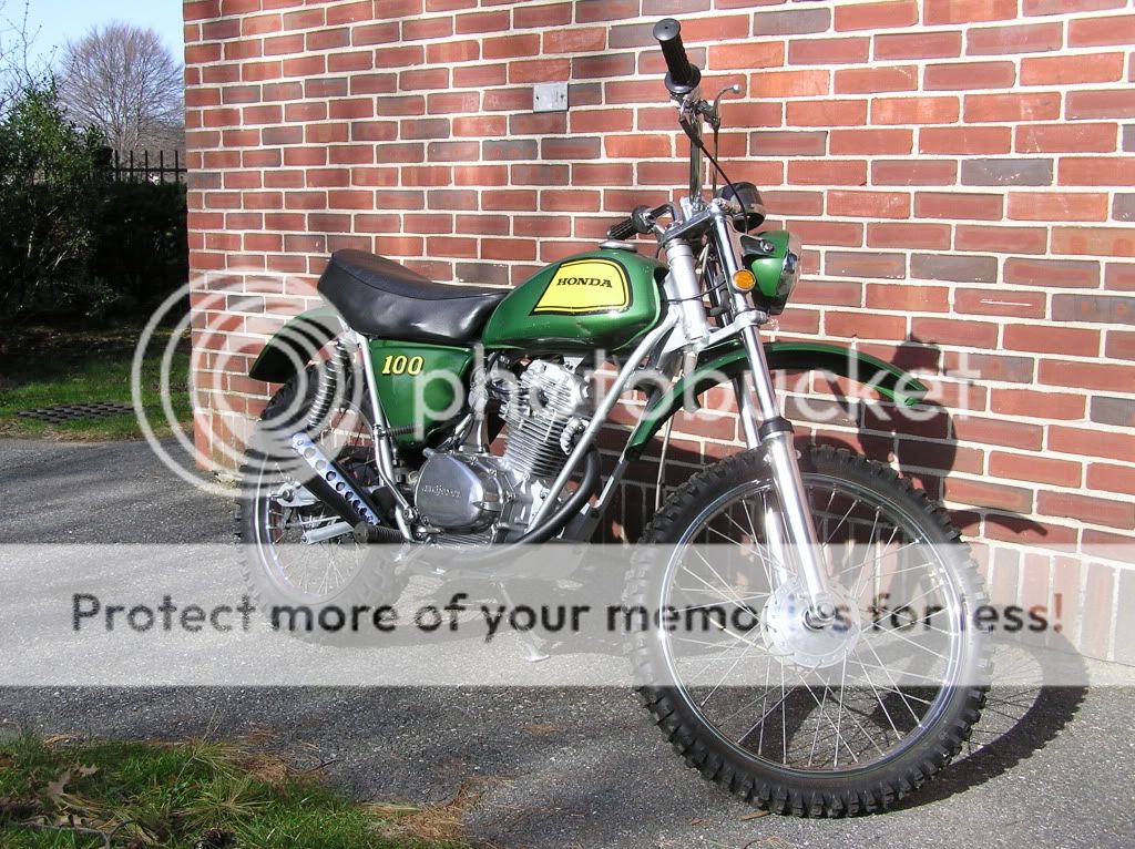

Posted 06 May 2011 - 03:29 AM
Nice bike, I will be watching closely. I have one too and love it.
It started here.

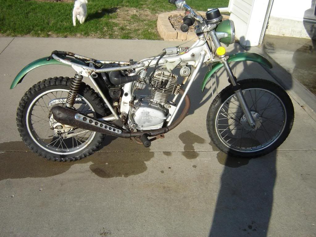

I have owned this bike for over ten years, it was my second resto ever. I ended up riding it for a bit like this.
I finally took it apart again and did everything - paint, new seat, the works. I use it now as a playbike but am thinking I may street it. This is what it looks like now.

Heck of a nice job on your restoration. I just got mine a couple of weeks ago and will start tearing it down here shortly. I noticed you polished your side cases. Was that your preference. I can't decide if I will polish or paint them. Also where did you get the paint for the fenders and plastic side covers? Again, nice job.

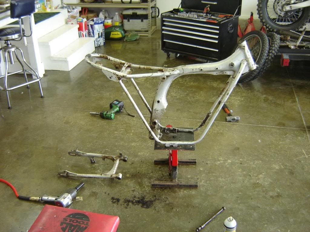

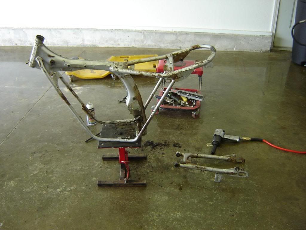

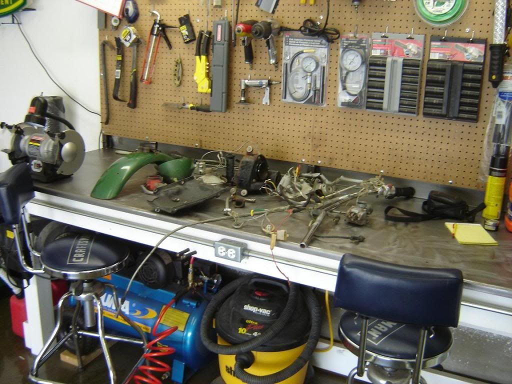

Well.........I got to spend a few hours this weekend in the garage working on the bike.  Today I got the frame and some other misc. parts to a buddy of mine who is going to blast and powder coat them.  The frame is going to be the same light grey with a bit of metal flake in it.
My first objective with this project is going to be getting this thing back into a rolling chassis so I don't have a large pile of parts sitting around in the garage.  It appears like this part of the build is going to be quite expensive.  The chrome on both my rims are trashed!  I need to get replacement rims and spokes (or re-chrome the rims and re-spoke), polish the hubs, new wheel bearings, new brakes, new rear shocks, and I need to locate some new front fork tubes because the chrome is pitted pretty bad, and the upper triple clamp is cracked and needs to be replaced.
Here are some photos of the progress:

Nice.   I need more garage space.   I get so jealous when I see a big garage.
You might want a scissor bike jack stand.   It will allow you to raise the bike up and not work bent over.   It's on my shopping list.

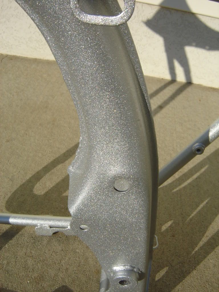

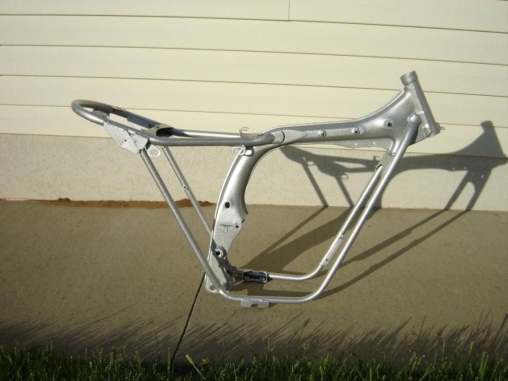

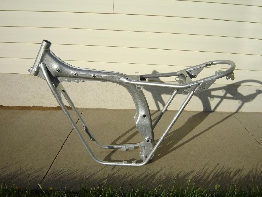

Well...... I made a little more progress on the bike.  Got the frame back from blasting and powdercoat.  Went with a similar grey color on the frame with some metal flake to dress it up a little bit.  I need to fix two small dents on the muffler and that and a few other odds and ends will get blasted and powder coated.  Also got all of the black parts getting blasted and coated.

Posted 24 May 2011 - 04:30 AM
Wow, your frame is looking awesome. Keep up the good work and the pictures coming. My budget won't allow me to take mine down to the bare frame, so I'm just fixing what has to be fixed to get it to run. Parts for these SL's are not the easiest to find compared to CT70's.
  • klp
Posted 24 May 2011 - 01:39 PM
Wow, looks great... keep it coming. Thanks for the compliments on mine - I am pretty proud of it.
The paint I got a match from a local auto supply house - it is close but not perfect, a little darker than stock. The tank I left alone.
The motor and forks I polished on a buffer with various rouge. I had never done it but was surprised with the results. I like it better than paint as it adds some contrast to the engine. It was A LOt of work though. Yeah. I don't know that I would do it again.

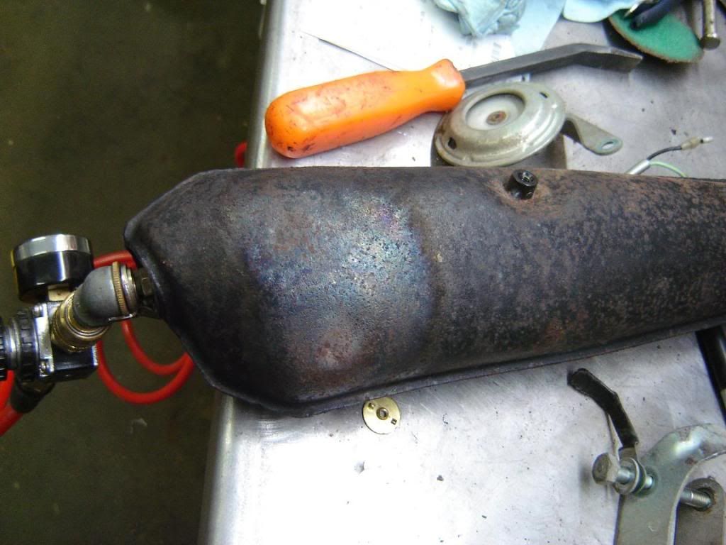

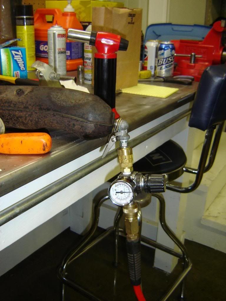

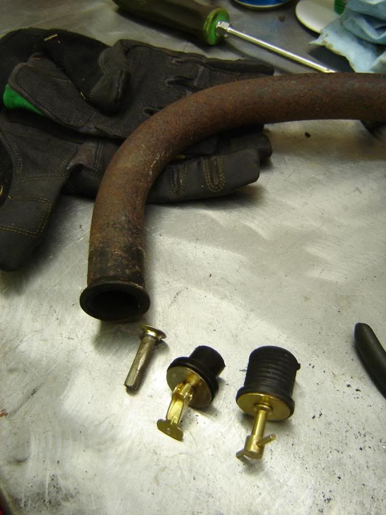

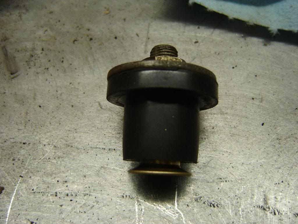

Well......I made a little bit more progress on the 100 tonight.  I had another little batch of parts that I was going to give to the powder coater but I needed to fix a couple dents on the end of the pipe first:
So I thought I would give it a try.  Since I couldn't get the baffle out my only option was to either weld studs on and pull them out or to pressurize the pipe and heat the dents.  Since I don't own a stud puller I decided to go with option 2.  Went to the hardware store and bought a couple plugs out of the hardware section:
Then I took the valve stem out of one of my old tubes and dissassembled one of the expandable plugs and used it as the center bolt and installed a washer and the valve stem nut:
Then I installed the plugs in the pipe and snugged them down:
Hooked up the air jack and pressure regulator:
Since my oxy/accetylene torch is at the farm I had to use a hand-held butane torch and quite a bit of pressure (125 psi) to get the two dents most of the way out:
It's not perfect but it's much better than it was before and I didn't want to push my luck and blow it out or destroy the pipe.
