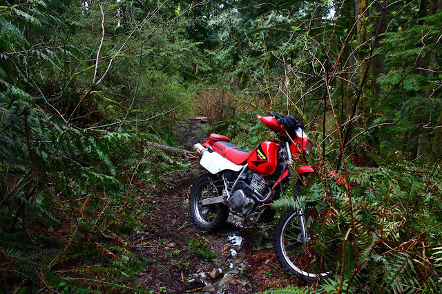

Just thought I would share some pictures...
mine is mounted a bit differently.
I cut off the right bracket for the airbox. still sturdy as can be.. I might fab another one up here soon in a diff location. this way the airbox top is more open and the fuse block and more electrical is under the seat on top.
I am going to glue some screen material on the right side of the airbox now. seems to get more air with the holes. they are underneath the side panel so it stays pretty clean in there. I noticed a little improvement after this in the butt dyno.. it is easier to pop wheelies.. I can pop wheelies through 3rd gear pretty easily now. 2nd gear throttle wheelies nicely too
battery size comparison.. the shorai might as well weigh NOTHING compared to that behemoth of a battery.
how it looks now.
I started with a bone stock XRL, and now with all the crap I removed and modded out, it is actually light enough for single tracking to some extent. it feels like a completely different bike! to think that keeping the battery setup stock seems ridiculous to me.. look at the CRF450, the batt is under the seat. if honda made a new XRL, this is probably closer to how it would be IMO. no nead for a boat anchor on the rear fender.
and NO, dirt and crap doesn't get into my electrical any more than it used to. I don't exactly baby my bikes either..
not using a kickstand here...
