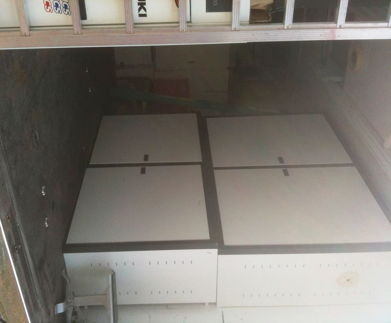

My box van already has a water tank & 12 v pump....just no bathroom but I am re arranging to make a larger sleeping area and have a small space for one in front of these cabinets.

Nice looking cabinets, where did you find those? It looks like they have the push-button type quick release latches, are they aluminum moduline type units?

Thanks .... the cabinets are aluminum and came with the box van when I bought it.
