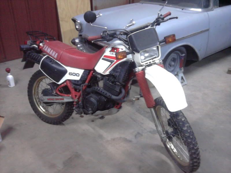

And not a yz80 stator, but the ignition coil. And the XT 600 have a dual phase stator anyways ( one pickup at 12 deg and another at 36 deg), but hell if I could get it to work I would probably try that too lol. That setup in the link is pretty sweet, but how much would 252 euros be? And the tach won't work? Plus, I'd prefer to use my hyperpak CDI anyways. Can't find any oem stators for sale for under $623 so looks like a rewind is going to be my only option, and I hope that they can repair the pickup coils too being that they don't show a part number for the kickstart XT's. I swear, I got one of the few XT years that is a total PITA to find parts for lol. xt550 stators are all over the place! As are the XT600E stators! I just want to ride her..... :lol: Well here's a pic of the $350 beast:
BTW we already trimmed the sagging front fender a bit, so it's looking slightly better (except for the fact it's in a few pieces right now lol).
