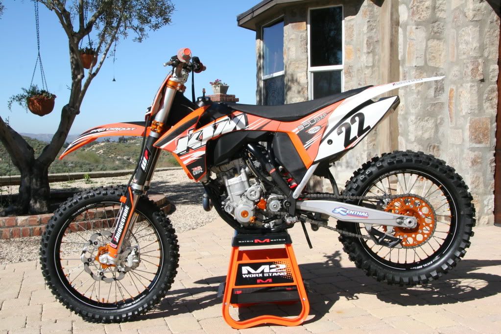

This site has been dead for a while. Here are pics of my 350 and what I have done to it.
3. Front Rear Tires  BS M 403/404-intermediate
4. Renthal Bars 994
5. Faster USA ultralight wheel set
6. Fastway F-6 pegs
7. DT-1 airfliter
8. Battery antigravity
9. 250 SX filter cage
10. Pro Circuit Full TI Exhaust
11. Hammerhead shifter
12. Sicass Racing mapping plug
13. Dirt Tricks timing chain tensioner
14. Braking rotors F&R
15. STR Fork Bleeders
16. KTM orange fork Guards open back
18. KTM Ignition Plug Orange
19. KTM hardparts Renthal rear sprocket +1 tooth 51
20. Oil Filler cap sxs.05.450.200
21. KTM hardparts clutch M/C guard
22. G-2 Quicktrun Throttle
23. Graphics Ride PG
24. Suspension  MX Tech Front & Rear
Posted ImagePosted Image

Looks great.  Most of the stuff makes sense but the rotors.  What was wrong with the OEM rotors and why do you consider the braking ones to be an upgrade?
  • freezkat
27 posts
Posted 28 February 2011 - 06:48 AM
Stock rotors are definitely excellent. Since I was building a complete set of extra wheels I needed a new set rotors as well . So since my friend knows the distributor for Braking USA he got me the rotors for less than the cost of the stockers.
