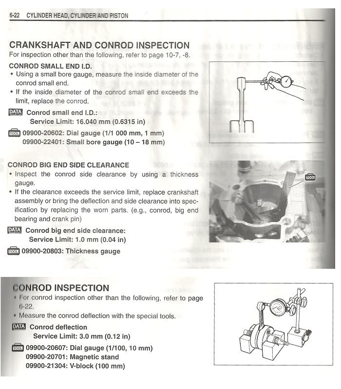

  • Eggbert
Posted January 10, 2011 - 04:56 AM
... the best way to tell how worn a bottom rod bearing is would be to se how much "rock" it has, not up and down play or side clearance, but actual rocking across the length of the bearing.
Turns out the book is confusing. Below is a pic of all the checks. The last check looks to be for rocking of the connecting rod. So....it appears that the deflection limit is total rocking movement, although one might think it would be movement measured from vertical, so half total movement.
Anyone care to comment?
  • Olalla7700
Posted January 11, 2011 - 04:50 PM
I believe that is from the neutral/center position, but 3mm seems like a lot for half of the side to side deflection... I'd think 3mm might be a bit much for total overall.
