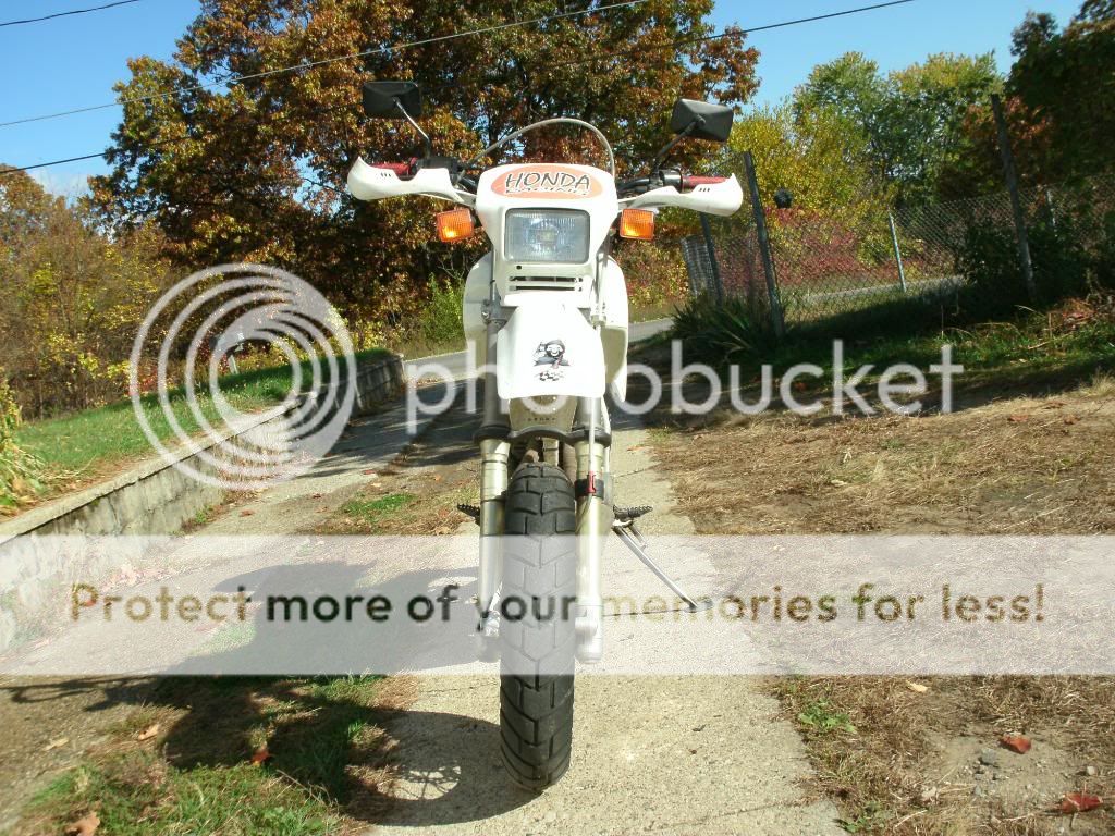

Pretty sweet build you have going, I tripped across ur thread looking for sources for a supermoto (shorty) front fender that should fit my '04 XR400. Yours looks pretty nice, mind me asking where you got it?
  • jpswift1
73 posts
Location: New York
Posted 07 April 2011 - 07:29 AM
The front fender is actually a "YZ Supermoto" fender from Maier.

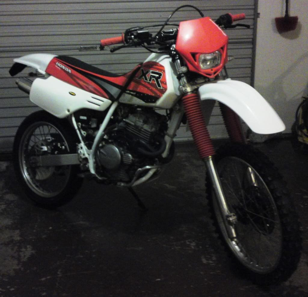

  • XR250INOZ
219 posts
Posted 17 January 2012 - 07:21 AM
Jpswift1 seems to be MIA or is on too nice of a holiday?
Anyway here is where I am up to>
Not the best pics (taken at night), I have my new LED blinkers and LED flasher can fitted and working sweet, I was given the 18" road tire (bridgestone battleax) a while back and near threw it in the bin at one stage thinking I would never use it, Well... it has near 90%+ tread & will do for now till I get some 17" rims and matching spokes
I plan on getting hold of a set of later 99+ XR250 forks so I may use a later model wheel/hub for the front
From what I have read the later 99+ forks are much easier to fit than USD forks, Much cheaper, They dont change the geometry & dont put the trail out
I also meant to ask what length (OR PART NUMBER) spokes you used for the wheels (I know you mentioned buchanan spokes)
Can anyone tell me what width 17" rims to use on an XR250?

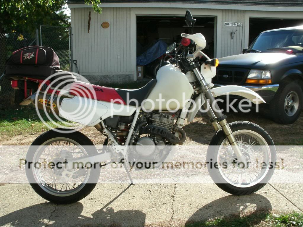

  • Jonny Enduro
141 posts
Location: Michigan
Posted 21 January 2012 - 05:18 PM

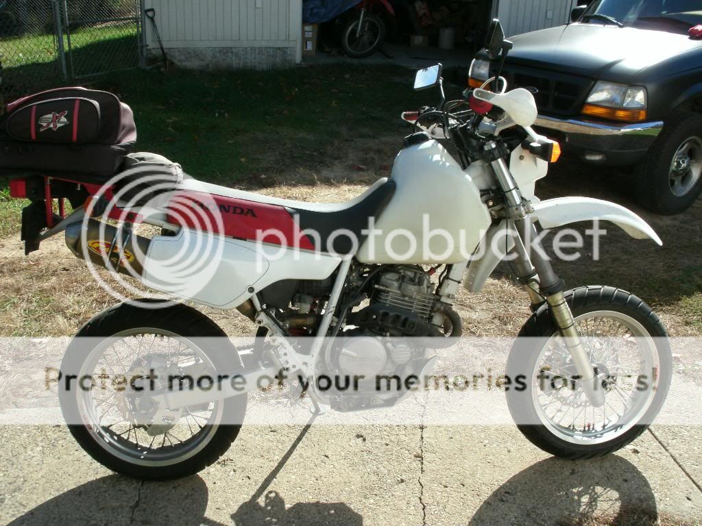

96 up XR250R forks are a direct bolt on, no need to change any thing else just swap the forks.
3.50x17 front  4.25x 17 rear bought my hoops and spokes from Pro Cycle.
Posted Image 93 XR250LSM
Edited by Jonny Enduro, 21 January 2012 - 05:20 PM.

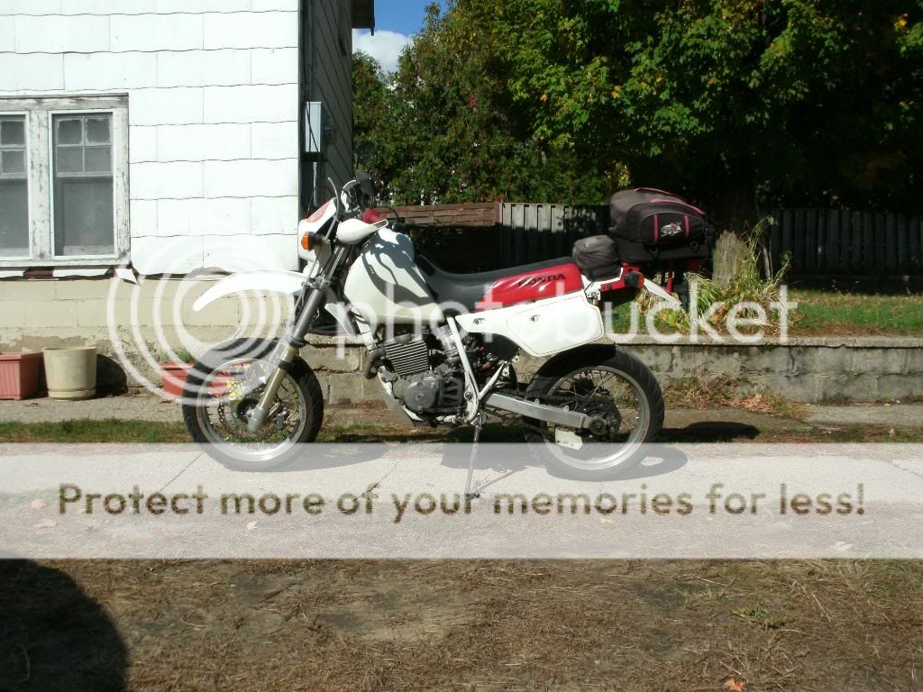

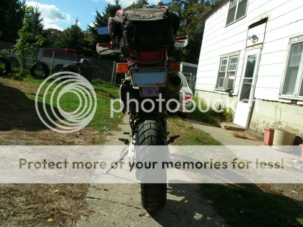

View PostXR250INOZ, on 22 January 2012 - 07:11 AM, said:
Thanks for the details Jonny, Anymore pics of your XR250LSM?
How tight in the swingarm & forks is the fit for the rims & tyres?
Great fit in the swing arm w/150 tire, front is a little tight w/120 tire but no problems with rubing.

  • XR250INOZ
219 posts
Posted 22 January 2012 - 01:05 PM
Thanks for the pics, Your bike looks pretty sweet with them wheels & fat tyres
Were you able to use your original pre 96 front wheel with the later model forks or did you use a late model front hub/wheel for the 17" rim?
Also where did you get your wavey lookin disc rotor's
  • MindBlower
4815 posts
Location: Indiana
Posted 23 January 2012 - 01:35 PM
Great fit with the chain guard removed.  :smirk:
150 BARELY clears (after cutting off other chain guide bracket).
140 would be the choice.
130 is really plenty of meat for these super light bikes with meager hp. (2nd pic)

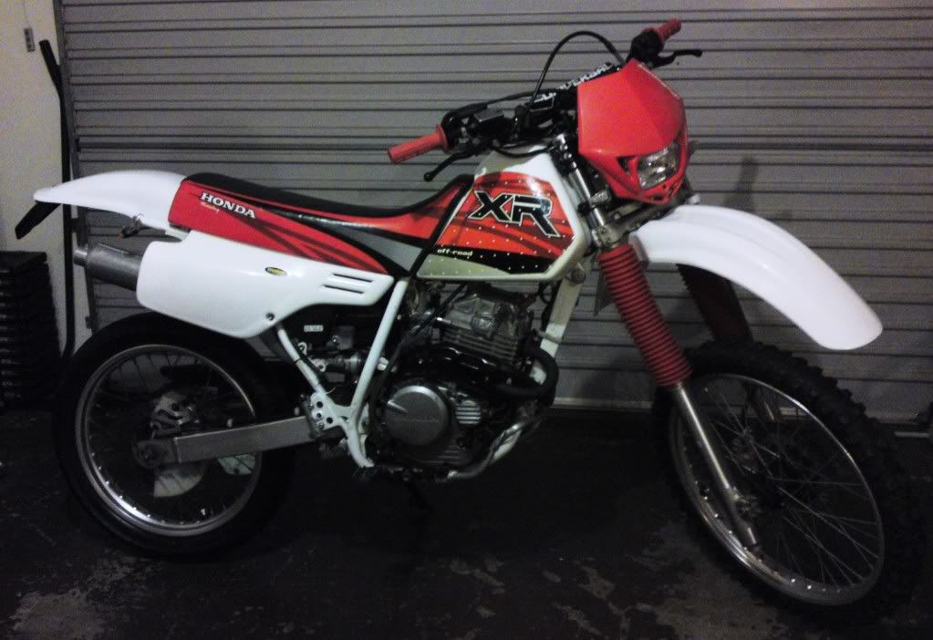

  • XR250INOZ
219 posts
Posted 23 January 2012 - 09:24 PM
Thanks Swift,
SHHHH, Dont say that too loud, It is infact an XR250R/P according to the complience plate and the paint code sticker that is still under the back guard behind the left numberplate, I am using a 250L pumper carb though
Its coming along slowly, I was lucky enough to find it in really good (MECHANICAL) condition even though it had heaps of parts missing & looked like something you would find at the rubbish tip, This was day one, Gee, I have not looked at this pic for a while, What a piece crap it was, No carby, No front caliper, No speedo etc etc, I took a bit of a gamble not knowing if it even runs but the motor is tight & feels like new>
I just fitted a new uni filter & im in the process of wiring up a new Trailtech Vapor speedo & matching Trailtech dash setup
I also wanted to ask jpswift,  What size is your rear sprocket & what brand? All the major brand name sprockets seem to be around 50 tooth, I want to run somewhere around a 44 or 42 rear, The 17" wheels will throw all the ratios out when I change over though
Less chain & smaller sprockets front & rear should amout to a little bit of a weight reduction and because its moving weight its an even better weight reduction
I used a 92 XR250L front hub and had the 17 laced onto it.
I don't remember where I got the front rotor, it's a EBC 280mm.
If I was to do it again I would go with a 320mm rotor.
Check with Sprocket Specialists they seem to have the largest gearing selection.
