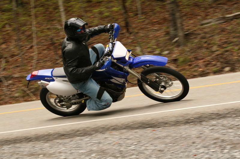

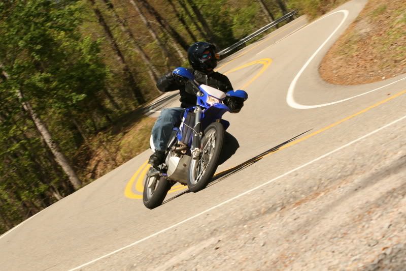

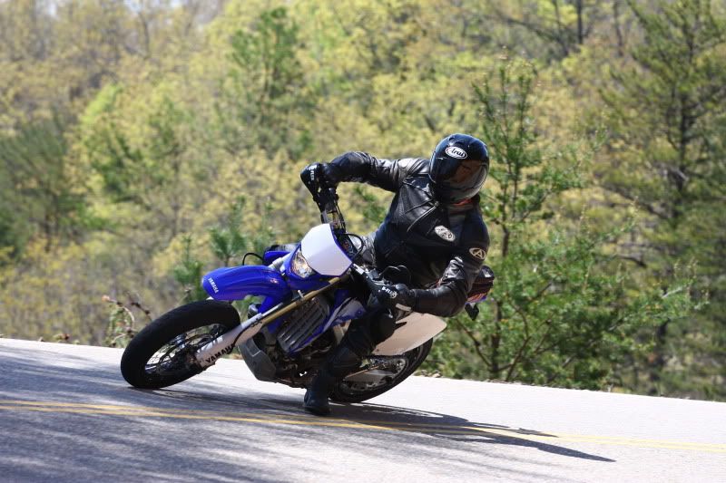

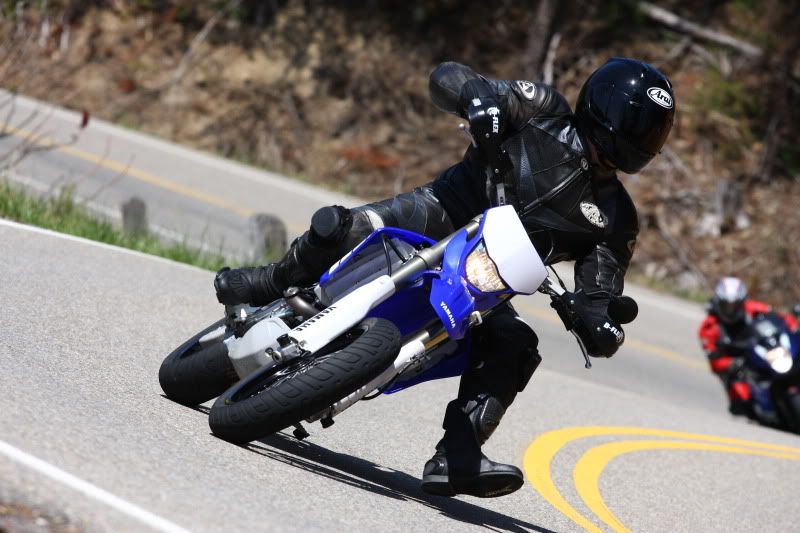

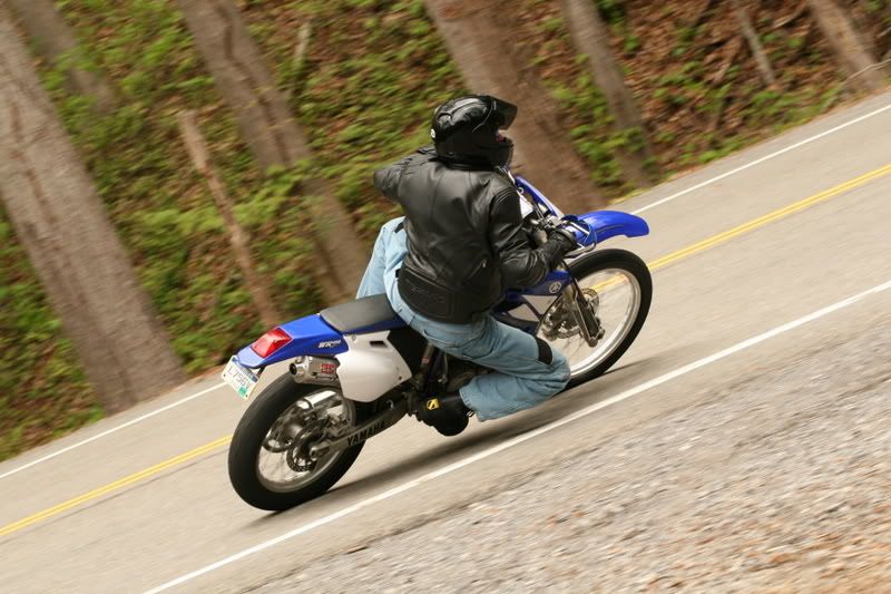

I have done two of them for street use, what do you need to know?
Here are a few pictures of my 2003 & 2007 WR450:

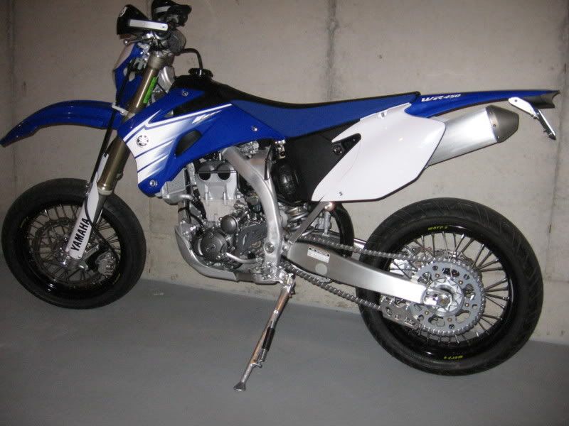

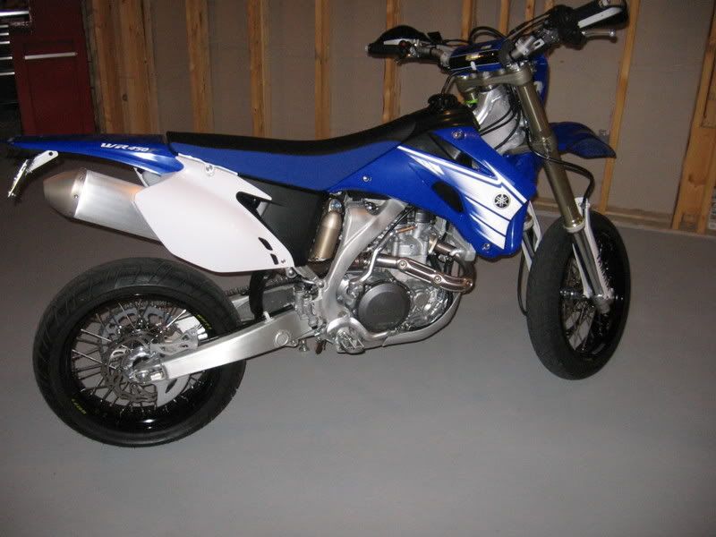

Here's my 2008 450:
The best advice I can give is don't try and go too wide on the rear rim/tyre.
I had all kinds of trouble trying to gain chain/tyre clearance with mine.

On my 2003 I had Excel 17" wheels, 3.5" front and 5.0" rear. A 160mm rear tire rubbed the chain pretty bad.
On my 2007 I had WARP9 17" wheels, 3.5" front and 4.5" rear. The 150mm rear tire fit well, with no chain rub.
You may want to try the sportsman 21/18 setup before you invest $$ into expensive & heavy 17's.
I ran Maxxis Promaxx M6103 street tires on my stock 21/18 wheels and the bike was very capable in the corners. Rode edge to edge on the front & rear tires with good confidence.

Hi Greg could you let me know what your rim sizes are, because they look just right to me.
  • WR450FGreg
Posted December 12, 2010 - 12:56 AM
Hans,
The front rim is 3.5 x 17 fitted with a 120/65 ZR17 Michelin Pilot Power tyre
The rear rim is 5.0 x 17 fitted with a 150/60 ZR17 Michelin Pilot Power tyre
I had to offset the rear rim by tightening the RHS spokes and loosening the LHS ones, then re-trueing the rim, along with shaving the side of the tyre and inventing my own "chainblock" to control chain slap, in order to stop the chain rubbing terribly on the tyre.
My advice is don't go any wider than 4.5" on the rear rim and maybe look at a 140 tyre too.
Also, the 120 front tyre is too wide. It rubs grooves in the white plastic fork protectors as they shake around. (Yes, they do move when the bike is mobile!)
Greg

1. Why are you wearing JEANS?!?!?!
2. Wearing jeans, on a dirt bike with road tires. Why are you sticking your knee anywhere near the ground??????
