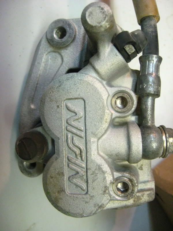

Gave mine a test run.
Caliper off an 89 kx, soda doesnt get into the deep oxidizing, might need to add some fine glass media to remove it. Looks 10x better then before.
I did the front caliper to my 94 KX yesterday. I had some black spots too. What I did was first clean the caliper chemically (simple green, mineral spirits, brake clean) only using a nylon brush except for bad areas. That's when you can wourk out those spots. The wire brush I use is the size of a toothbrush, you can get them at Lowes or a welding supply shop. After you have it cleaned you can soda blast. That will give it a clean but dull look. So I found that going over the part lightly with another clean wire brush gives it a little shine and deepens the color a bit. Go real light like your just buffing the finish.
This side was where alot of the oxidation was. There's still maybe 5% residual left, but it's alot better than what it was.
