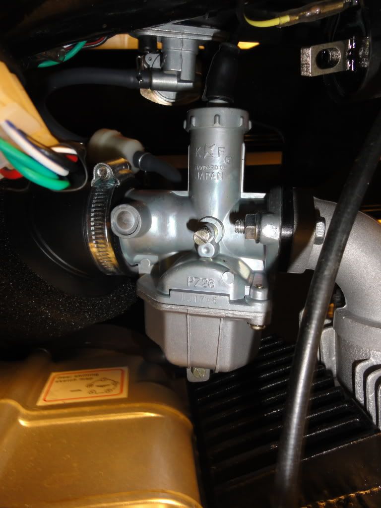

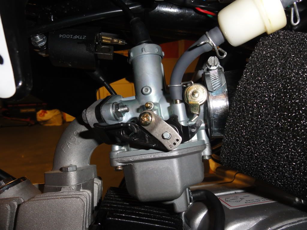

Hey everyone i am having some issues getting my SSR 125 pitbike to stay idling. I just bought the bike about 2 weeks ago and the idle has never been able to run without the choke being on full. Now it is having a hard time keeping running even with the choke on full (since i have been playing with the settings). It also backfires a little, but not bad and there is no smoke. The bike also runs pretty good when moving, but i have to turn the choke off when moving to get it to run good. I am just not sure if i am doing it right. I am including pic's with this post. Can some please point out what i am suppose to be changing? Any help would be great. Thanks.

also the screw on the right hand side of the carb is your idle screw it'll raise and lower your slide(in raises idle out lowers idle) pop the filter off and make shure it isnt closing all the way
I checked and it is not close to being closed (i would say about 1/4 open, with no throttle). Is that bad?

Here is the location of the fuel mixture screw, this is the screw eavery meant.
You were opening the float bowl drain screw.
