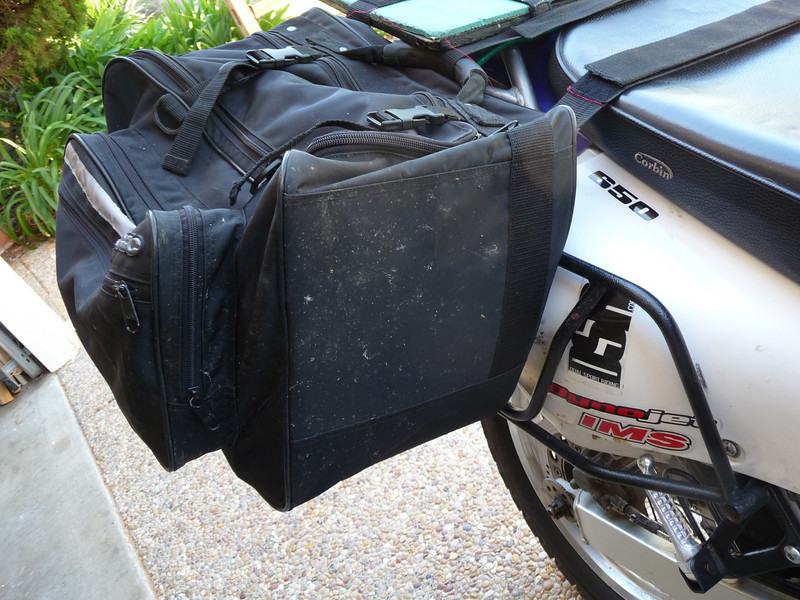

Loading up the DR for Long Haul travel
Lots of ways to go here and none are strictly right or wrong. Hard bags, soft bags, Dirt Bagz style, Giant Loop, Ortlieb Dry bag duffles, Wolfman, Happy Trails, Pelican cases and many more. They can all work on the DR.
Which ones you choose will depend on the type of ride you're planning. The really good news here is that the DR650 is one of the best 650cc dual sport platforms for carrying a load. Better than a XR-L, better than a KLR, Husky, KTM, BMW or whatever. If the Yamaha XT660 or new Tenere' was imported to the USA then the DR650 might have competition in this regard.
Tourmaster soft bags and duffle. Simple, cheap, functional.
The DR650 has a strong rear sub frame and main frame. I don't think I've ever heard of one cracking or breaking. (other than from crash damage)
The DR may be heavier than some of the competition but I've found in an off road travel bike that strength is a good trade off for weight, if not too extreme.
What I learned from traveling with various luggage configurations on the DR is that "Light Is Right". Repeat this mantra as you prep for your trip. It's all well and good to bring the kitchen sink so you can prepare five course meals every night ... and we all rationalize this a thousand ways, but the fact is, too much is too much. Going on the road you have to think different. You can't have it all and still have a capable and versatile bike.

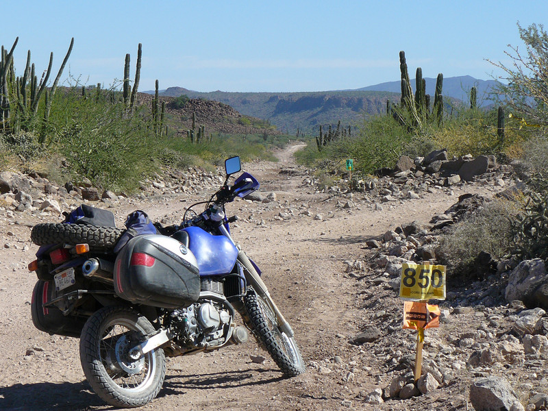

I did an extended Baja/Mexico ride with Givi E41 hard bags in 2007.
These worked well and even crashed pretty well, not cracking or busting into pieces. But the added weight and ability to carry TOO MUCH stuff overwhelmed the DR off road. In rocky slow going or higher speed loose stuff, the over loaded DR was all over the place. My bike has heavier springs front and rear, but it needed more to do well off road with 110 lbs. of gear on board. (includes weight of hard bags themselves, racks & hardware, spare tire, tools, tubes, parts, food, clothes, duffle bag and misc. stuff)
60 lbs. in this mode. Camping gear in duffle on top. (bags: $60, Duffle: $30)
With the hard bags and duffle I had plenty of room for all this and could have taken even more. Bad idea if you plan to spend time off road in anyplace more technical than a fire road.

Large soft bags ... maybe too large? They weigh nothing and Happy Trail rack is also very light but keeps bag off pipe.
