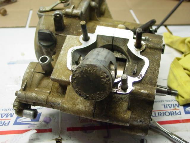

I bought this '04 KX 65 for $300 a couple of months ago. The person was originally asking $500, but after I saw he split the cases with a couple of screwdrivers, I got him to take off a few hundred since I'd have to find some new cases.
The previous owner did a great job of keeping all the parts to the engine in the two buckets, I was very impressed that nothing was missing. With the exception of a small tear in the seat and the front tire, the rest of the bike was in great shape.

what in the **** happend to that piston
