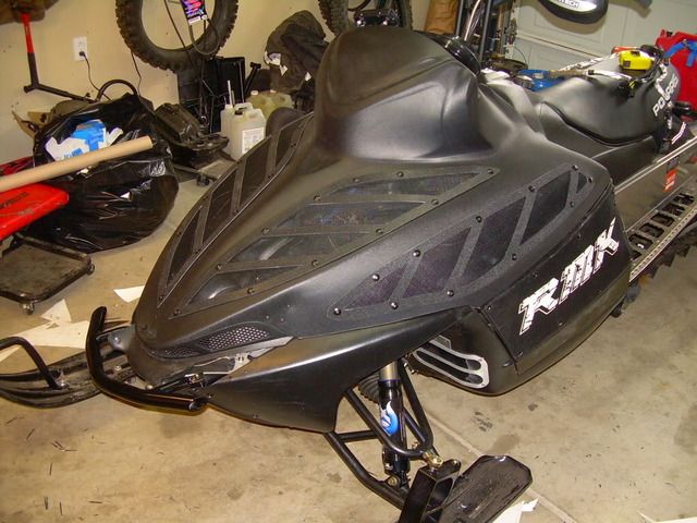

Personally I've taken my sled to a bit of an extreme level for performance. Boondocker Turbo kit, Turbo specific porting work, Holz Coil-over Rear suspension on custom rails, Fox Float 2's up front Holz Spindles, Lightweight hood, RSI Bars and risers and some other stuff to make it better. I've got over $15K invested in it and it's an absolute blast to ride. Here's a few pictures for reference.
