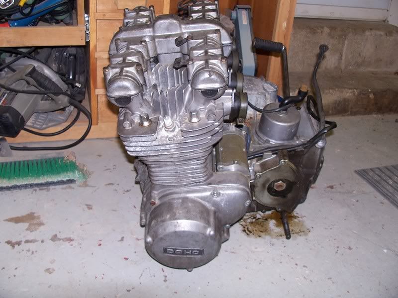

This was my Fathers 75 Z1 he bought new the same year I was born.  It was stored in his garage (2nd wife didn't want him riding) for 14+ years.  He passed in 97 and when the bike saw the light of day it began to deteriorate pretty quick.  Surface rust popped up everywhere and the clear on the tank lifted, any of the zinc plated hardware/spokes tarnished.  So I tore it down a few years back and finally getting around to restoring it.
