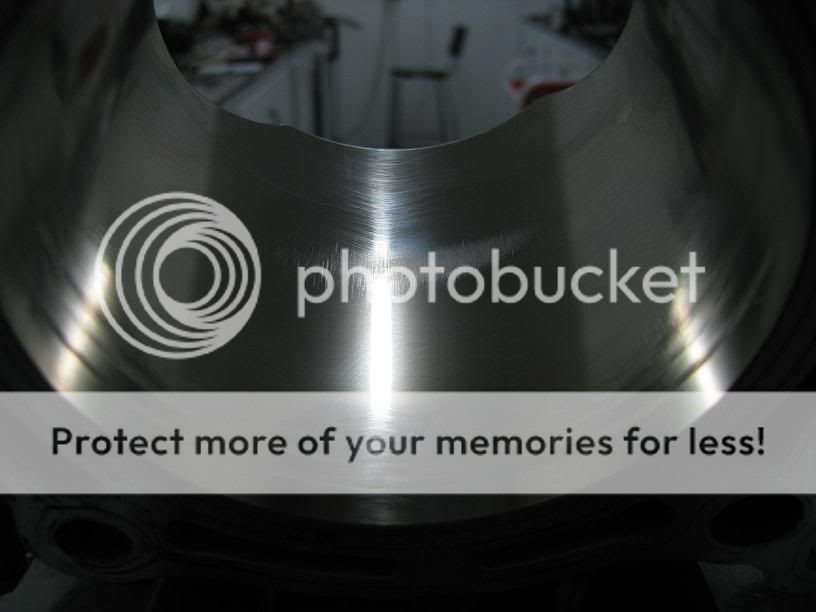

I present my case.
While this is not a honda, it is a 08 yz250f cylinder, this was honed today by my engine shop.
Now, the cylinder clearly had scuffing and ring wear marks before honing.. but have a look at just how good we can determine the cylinder condition after a hone with a fixed stone hone.. We can clearly see scuffing severity, and determine that the cylinder is ok to go again. Its LESS than ideal, but since its honed, we now know there is no high spots especially where the ring wear is.
IF, we went ahead and had used a toilet brush ball hone on this, it would have masked any high/low spots, and would give a false impression of actual cylinder condition. That scuff patch would have blended in, and so would the ring grooves.. A scourer would have simply cleaned off the oil.
We know that the rings are not going to contact the cylinder where the scuffing is, as the hones have only just skimmed that area, and the ring seal at TDC is also going to be suffering, but we know exactly what to expect from if.

I present my case.
Brad

I absolutely agree that the original point of the thread was asking can a cylinder be cleaned successfully at home.. and sure, you can clean it up good.. But you cant 'hone' it so to speak
What I wanted to do, was take the discussion further, and perhaps put up some information for those people who are a little confused about what the different options offer.
So, I will say this for people who are thinking of going either way.
If you think the cylinder looks to be good, and has a original honing marks all over, you can successfully clean your cylinder with some scotch pad. Even if it has some scuffing, you will be ok..
But, its like everything, you only get out what you put in.
So, if you put more into it by getting a correct hone, you will get a better result with ring break in and oil retention.
The proper way to hone nikasil, is with the tooling ive already mentioned. However, a deglaze hone will only take the smallest amount of, like 0.00025" or more if you wont to try do some repair work, which is no where near wearing through a 0.003" thick coating. It will not cause chipping or any other problems. Have a look, those ring grooves are deeper into the nikasil than the hone job went, and there is no nikasil chipped off in that area. Id probably have to hone another thou to get rid of them grooves completely. But then piston clearance would be getting a problem
If you have a bad cylinder, sure, get it recoated by millenium etc or U.S chrome.
If you find a machine shop that can do porsche engines, they will have the diamond hone tooling, as they will hone porsche nikasil bores all the time.
