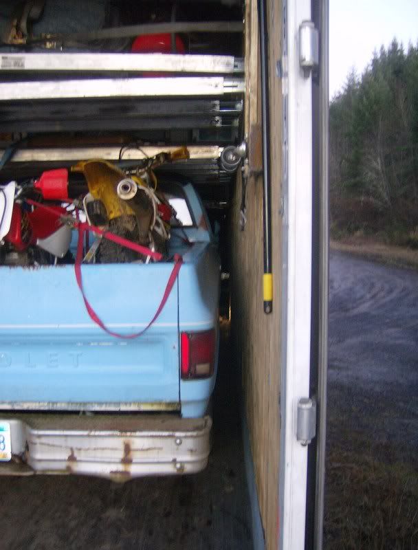

  • Chickenhauler
Posted March 18, 2010 - 01:22 PM
Good reminder, that eBay has lots of e-track ... but that actually highlights my brand question even more: does it matter WHO made the e-track or attachments? Do they all interoperate well?
E-track is E-track, it's like 1/4" drive sockets, they're all interchangeable with each other.
Okay, I'll hope for the best re: brand.
Re: the load locks are interesting but not workable for me. I need to be able to handle 6 dirt bikes in my 7x16 v-nose, which means the center bikes need to be shifted forward a foot or so, so the front wheels will not line up.
If I had a taller trailer, I would use E-track to make a second "deck" over the bikes to maximize my storage space-toss the riding gear and chairs and such on a second deck over the bikes.
Kinda like this, but on a smaller scale: (this is in my semi trailer)
