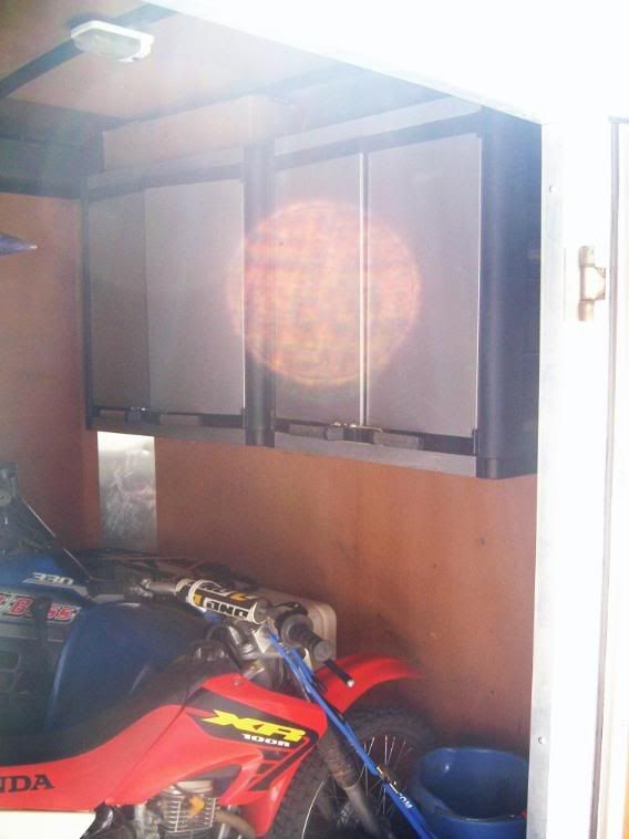

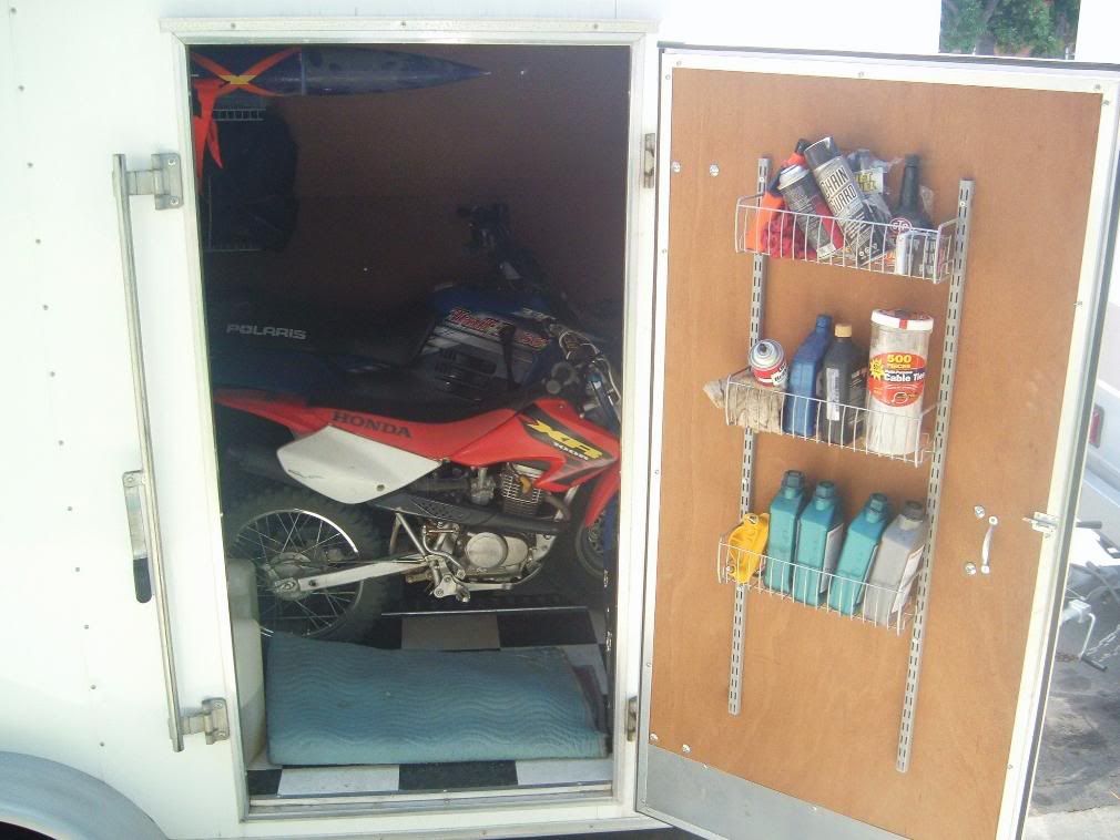

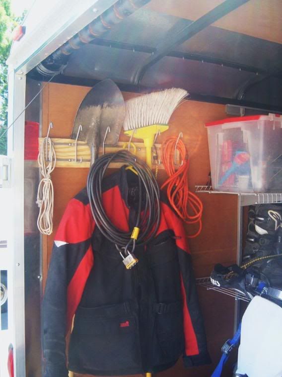

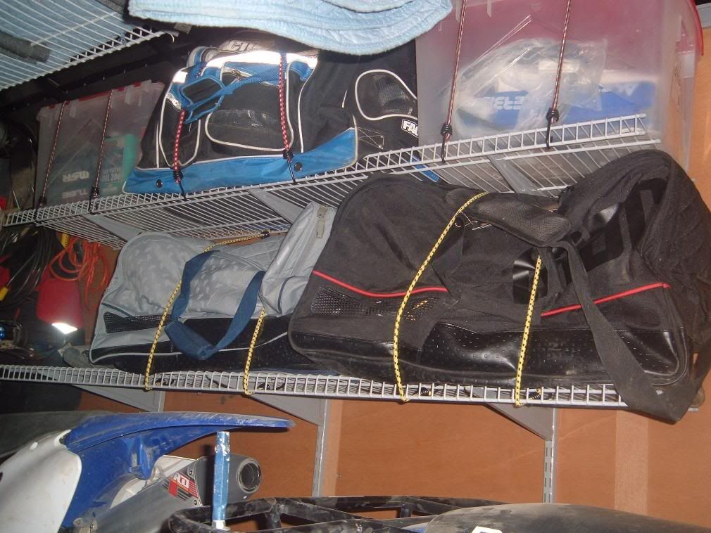

I bought some steel wire racks from Home Depot (or was it Lowes). They mount to a vertical piece that I screwed into the steel frame ribs of the trailer. Allows me to adjust height and store a number of things like crates and gear bags. Has worked great for the last couple of years. Here are some pics:
I also mounted two enclosed cupboards up front:
And a rack for Oils and such on the door:
