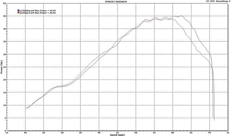

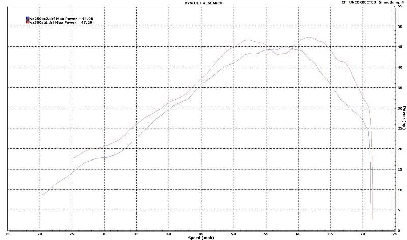

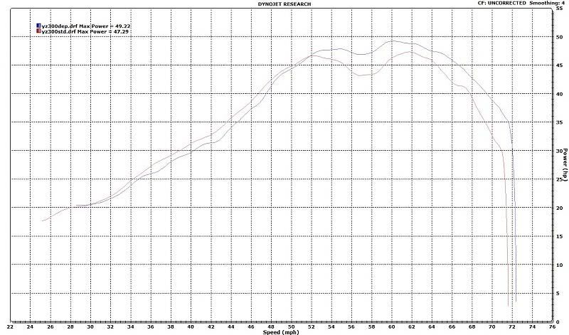

Just noticed some of the charts disappeared.......
250 dep (blue) v. 250 PC2 (red)
300 dep (blue) v. 300 stock (red)
300 dep (red) v. 250 dep (blue)
300 stock (red) v. 250 PC2 (blue)
