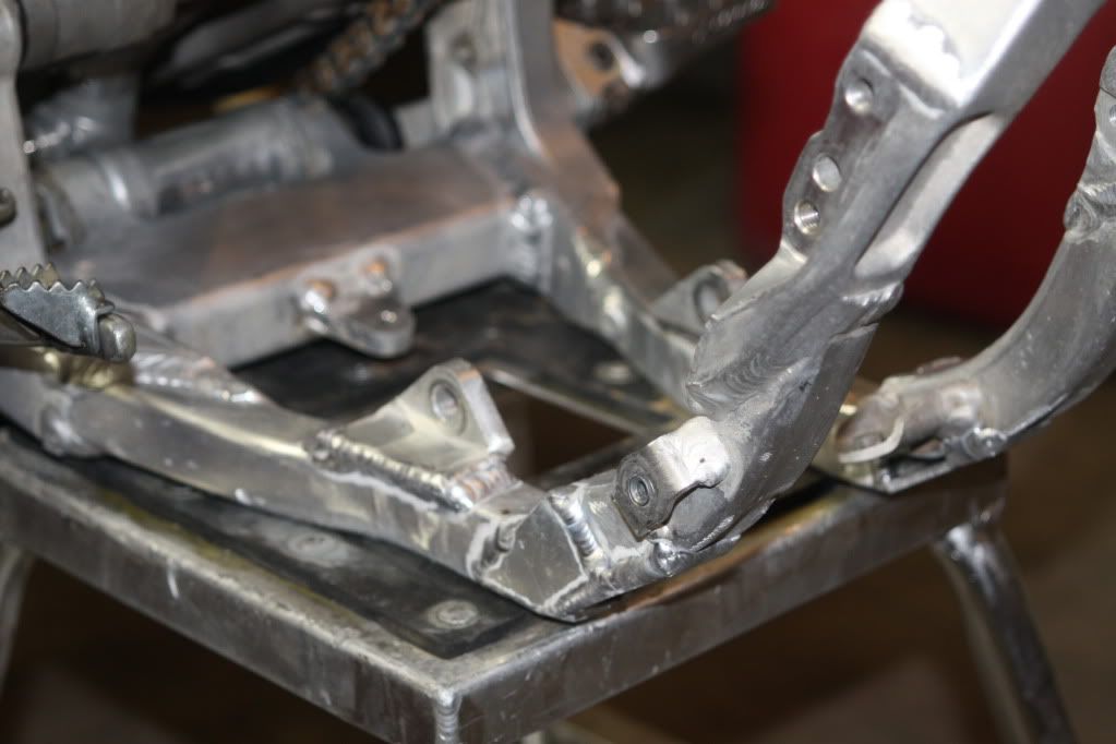

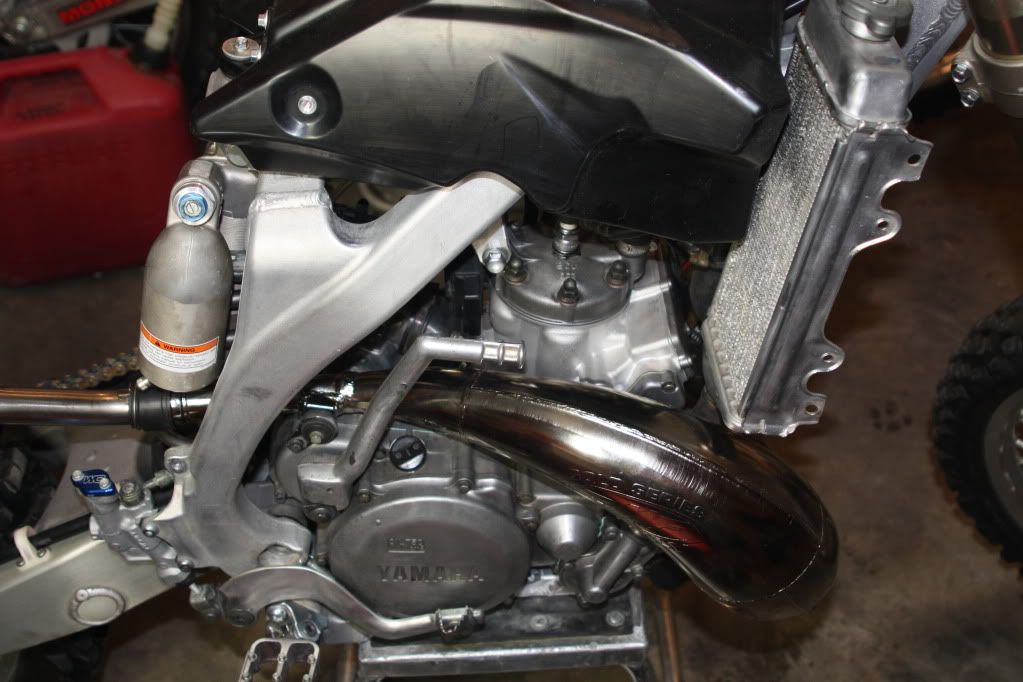

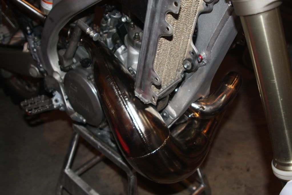

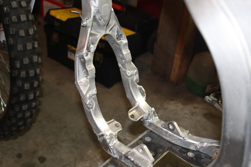

Well I got my frame back from the chopper shop, wasn't exactly what I was thinking, but I think it will work good anyway. Check out the pictures.
They moved the bottom rails back and up a little to accomodate the pipe. The pipe has a nice clearance now and fits great on the motor. I acid washed the frame before I put the motor back in and it turned out good. It got the aluminum nice and bright again. I think I will do that to my 4 stroke when I rebuild the motor in that here shortly. I got the motor planted in the frame but an still undecided on how I am going to mount the electronics. I did however get the radiators mounted, they fit great with the Dr. D radiator lowering kit. It moved the radiators just enough that there wasn't any interferance with the frame or motor.
I got a little anxious today after work and took it out and blasted it up the street without the airboot. I forgot how much I love the smell of race gas and 2 stroke oil. It filled my lungs and now I am addicted again. I would just start it to smell that smell again. I did get my new carb vent hoses on today after the ride up the street, and then went in and started on the airboot. Hopefully I will get a few more layers on tomorrow and work and getting that installed early next week. I think I have all of the parts that I need to finish, just need some time and patience now. As always I will keep adding photos as I progress.
