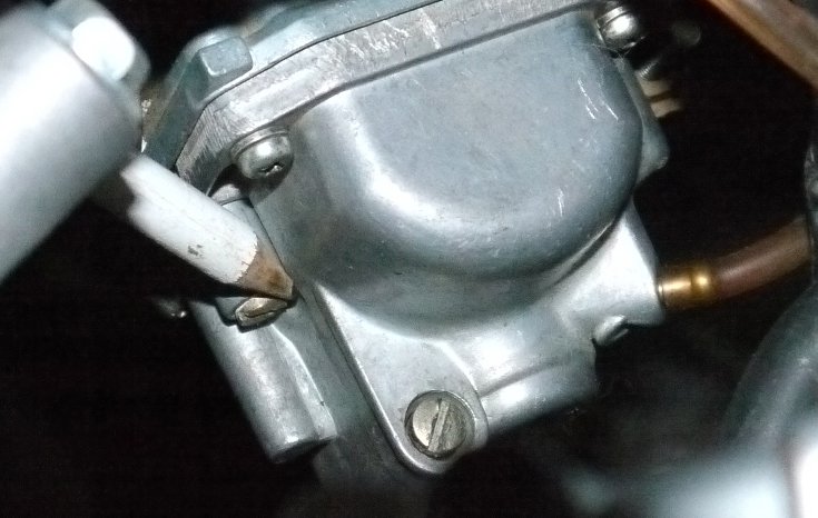

I have had two ttr125s an 02 and an 03. Both were hard starting. I found that I could adjust the idle mixture and take away the cold blooded nature to them.
Here is the needle jet location, I'm pointing to it with a white pencil.
I used a flat tip hex tool to adjust it for the highest idle speed.
