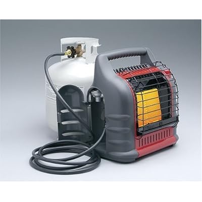

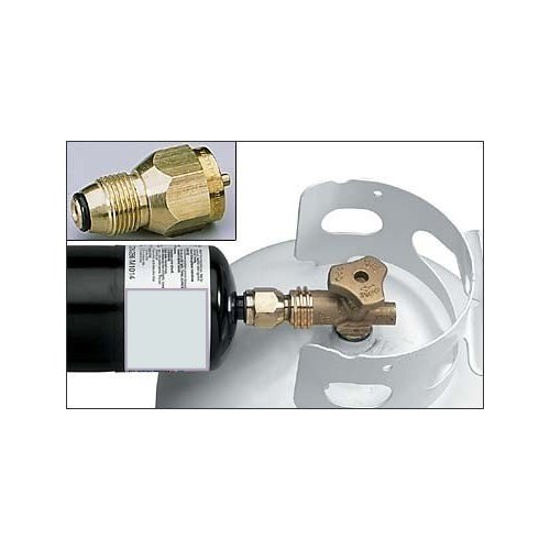

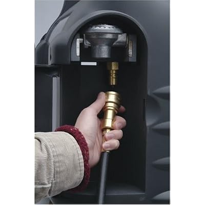

  • Goebz
Posted 15 December 2009 - 11:12 PM
IF YOU SEARCH ENOUGH YOU CAN GET TEH BIG BUDDY FIOR $100
It will run off 2tanks and has an electric fan to push the heat out.
You can also run it off a 20lb cylinder with an adapter hose.
You can also buy a fitting to refill your small tanks from a 20 lb, this has save me tons as I use this to heat my 2 car garage in the Ohio winters.
Posted ImageIt is also very quiet.
I bought the nice lined carry bag from Cabela's and it holds 2 extra tanks.
