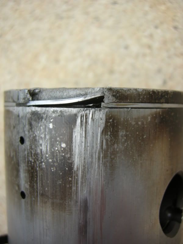

Actually everything in my research regarding my 2003 CR125 states that you can NOT big bore it. I had my piston blow up due to a drop of water getting past the head gasket just 2 weekends ago. The piston grenaded on the exhaust side and scratched the jug pretty bad. I ended up getting a brand new jug from service honda for $255 as well as new top end kit and head for a really good price.

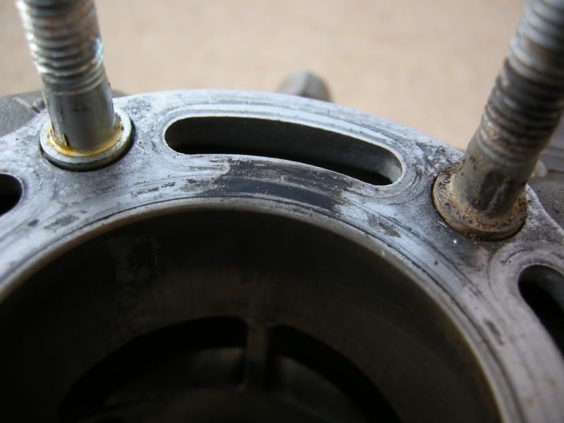

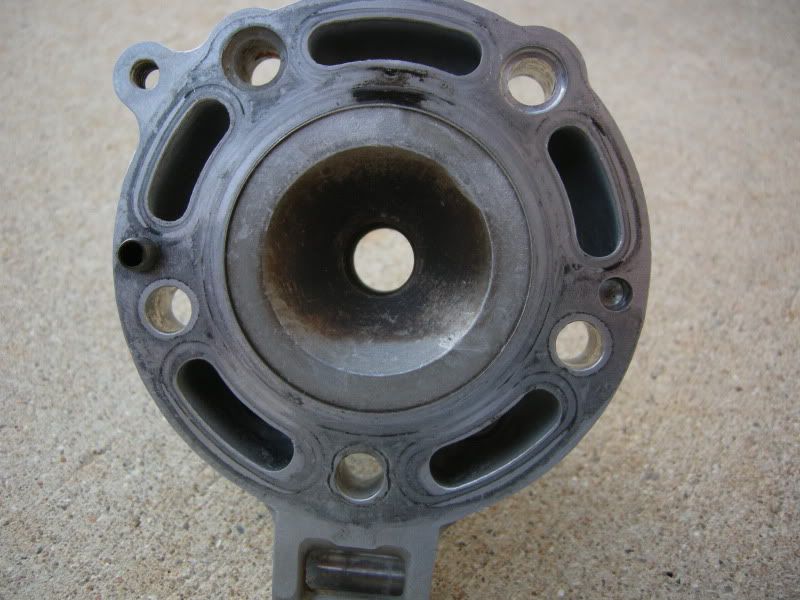

I don't think the stud backed out, I tried to take them out last week and they're not budging. I used a level and feeler gauge and there's a bit of a gap where the head and cylinder meet at the port where the coolant enters the cylinder from the head. There's also a black mark that I wasn't able to remove on both in the spot where I think the coolant got thru.
When I was cleaning the parts up I was trying to figure out what happened i.e. too lean, over reved it, ect. and came across that mark and then it came to me. The piston blew off a chunk, which hit the spark plug and degapped it. The piston ring split and thats what gouged up the cylinder wall. I will take pics this weekend and post them if you guys/gals want. This was a Weisco piston, and no I'm not saying anything bad about them, it would have happened to any piston given these circumstances.

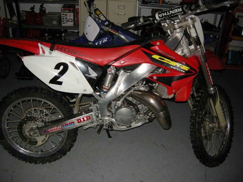

Ok, got the bike rebuilt this weekend, here are some pics and some answers/comments.
The power valve sucks to get put back in.
The studs are all the same height, but the two on the exhaust side don't sit as low in the cylinder than the others.
All in all, it was a fairly easy job to do and putting it back together took me maybe an hour and 15 minutes.
It is easier to put the cylinder back on the piston with the piston about 1/2 way thru it's stroke, and compressing the ring while putting the cylinder on would have been easier with a second person to help.
If you have any questions let me know and I'll try to answer them as quickly and accurately as possible.
In these pics you can see the black spot on the cylinder and head where the coolant was able to get past the gasket. I didn't measure the head but there is a .002 or was it .02 gap where the black spot is on the cylinder.
