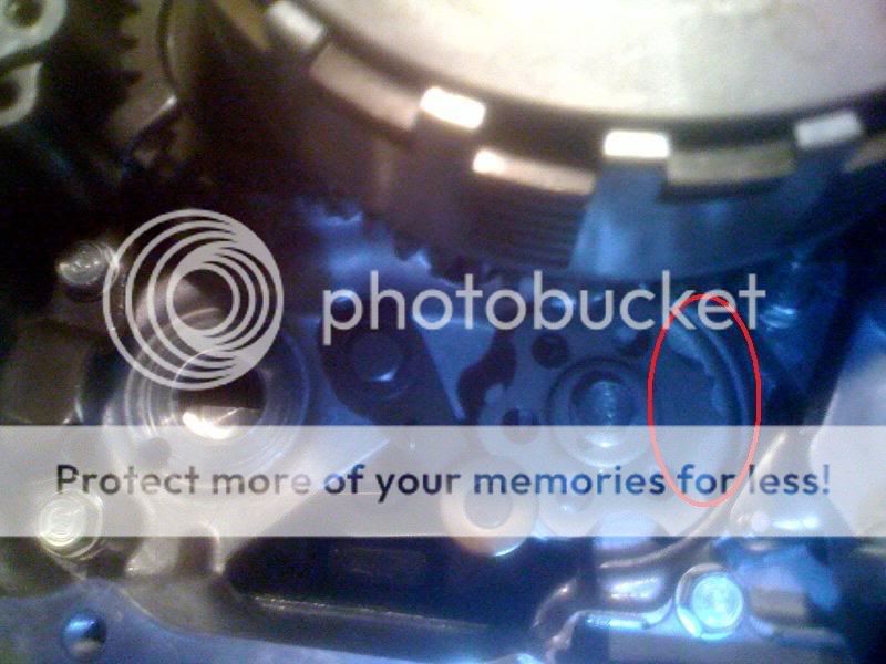

Indeed there is a spring, bad news is you have to split the cases to access/replace it. Unless its your stopper arm like in this photo below, the arm next to the gear circled in red. Than all you have to do is take the right side cover off
My guess is on the shift shaft spindle there is a spring that puts forward pressure on the fork type thing that clicks into the shift drum. I may have a photo at home of what im talking about but i can imagine if this spring became dislodged you would have the problem you are describing.

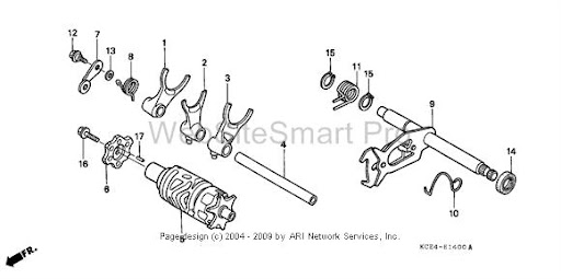

10 in the picture is labeled gearshift reset and 11 is labeled gearshift return.
If I have to split the case I'm not going to be happy!
Edit: the picture might help!Posted Image
  • tek_01
Posted October 26, 2009 - 07:53 PM
I was talking about part number 10
Its so damn flimsy i dont believe they trust that in the gearbox.
Afraid to get to those parts you have to split. you can just see a bit of part 9 in my picture above if you look through the large hole

I purchased a 93 xr250r for cheap because he removed the wrong bolt to change the oil. Removing that bolt made the return spring drop and fall into the wrong position. I was able to fix it without spliting the cases. I removed the clutch side cover. I had small light that is used for model trains and wired it to a longer piece of wire. I was able to feed the light into one of the holes in the case and was able to see the spring. I used a coat hanger and lifted the spring up. I pushed the bolt back into place and painted that bolt red as a reminder to never remove this bolt. From the pictures I believe the spring in question is # 11, at least that's what it looked like. It controls the shifter and moves it back to center when you move it up or down.
