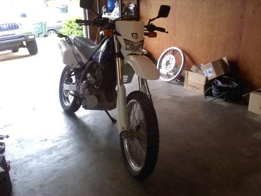

This is my first post so bare with me. Ive got a 2009 DR650 that i think is a great bike on the road and an ok bike off the road. I spooned on some D606's and it got better, then i quickly realized that the front fork straight up blows. I looked into the fix kits with springs and such but decided i wanted to go the USD fork route. I read other ppls posts using ktm WP forks and the likes. I also saw a drz400 fork swap but thought it was alot of work for a slightly bigger but still not stellar conventional fork. I pulled the trigger last night on a 2005 RMZ450 complete triple clamp with bars stem and bearings. I got an OEM front axle and a set of 06 RMZ 450 forks. I havent bought a front wheel yet in hopes of Either cutting down the RMZ axle or fiding bearings that fit in my DR's hub. My question is this. does anyone know the head tube bearing sizes for both the DR and the RMZ. from the looks of it i'll be using me DR's outer races and a hybrid bearing to fit the RMz stem. I also gave slight thought to machining down the rmz's stem to acept the dr's bearings. What does the forum think? any comments are appreciated.

Hi, I had the same sort of issues when I swaped a KX front end on to the DR . Check the stem size where it is pressed into the bottom clamp, and if it is the same size press the RMZ stem out and the DR one in. Then you can use standard DR bearings.
This also fixed the problem I had with the stems being different lengths.
Good luck with the swap, It may be a bit of work, but it is worth it. You will probably want to do a shock overhaul at the same time as the back will seem to be 10 times worse than the front after the swap over. DRZ400SM headlight brackets will make the head light remounting a lot easier, they are the same type as the DR, but have the larger holes to mount on the USD forks.

don't know about the stem being the same length, but they use the same stem bearings as the DR 30x52x16. i have 2000 rm showa forks on mine and the RM stem fit ok. good luck

turns out the DR stem will press into the RMZ triples making this a pretty simple swap. the added width of the tripples makes the brackets for the front plate/headlamp not work very well so i'll have to mod them alittle. as for the wheel im still working on it. A DRZ shock is in the works as well but one thing at a time

I used USD forks from an 01 RM250. All I needed were the forks, triple clamps, and front wheel and brake rotor. The DR caliper bolts right up to the RM forks. The DR and the RM use the same size of steering stem bearings. Super easy swap. Did it in an afternoon. No machining or modifying required.

I honestly haven't had a chance to ride it hard enough. The springs are stock for now. It felt much stiffer than the stock DR's. I did it right before I moved to Texas for a summer internship. The stock RM brake rotor was warped and way too small. But I have a 280mm rotor to put on when I get home in about 3 weeks, also going to motard it. :smirk:
