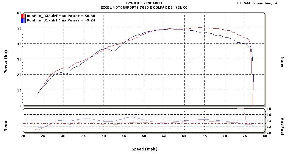

heres a dyno graph from a crf that has one these air box eliminators.
the blue line is after installing the air box eliminator.the customer threw it away and went to a 05 crf air boot.
