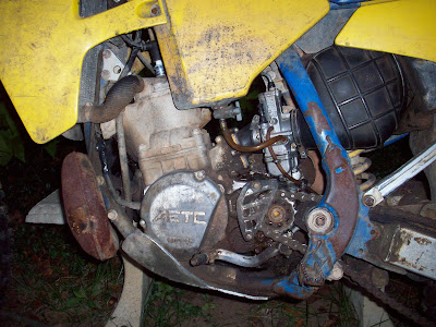

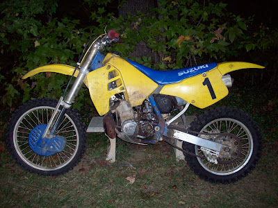

I just picked up a 1992 RM250 as a project bike and I have some questions that I'm hoping I can get some expert advice and opinions on. It's been a long time since I've owned and worked on motorcycles, so I will really appreciate any and all opinions.
1. Overall--Is there anything I should know specifically about the 1992 RM250 that would help me know whether this is a model that is worthy (or not) of a rebuild? I'm thinking about things like...this bike was terrible when brand new, why would you want to restore it? or, this bike is an awesome ride, give it some TLC and you'll be pleased for years to come.
2. I've got a Clymer manual on the way, is that the only manual option? or should I pick up others?
3. The pipe was a terrible fit and horribly dented. What should I consider as a replacement?
4. I've got the clutch taken apart, what should I look for in terms of deciding whether I should replace it? What are my clutch options, from most to least expensive?
5. What's the best way to loosen the nut that holds the clutch basket in place? I want to break the whole thing down and split the cases to take a good look at everything.
6. When I pulled the crankcase cover off to look at the clutch, the oil was grey and creamy looking (had the look of melted ice cream). Other than that, everything looked clean, with the exception of some grease and grime that I introduced when opening it up. What's the best way to clean this up before reassembling? Should I clean it all with solvent and then seal it up and add new oil?
7. I pulled the rotor off using a flywheel puller, but can't seem to loosen the rusty phillips screws that hold the stator to the crankcase. Any suggestions on breaking these loose? They aren't horribly rusty, but have a little rust on them.
8. The frame also has a little rust on it. Any suggestions for cleaning it up and then painting it to avoid future corrosion?
I think that's all I've got now. I realize there is a lot here. Please don't feel like you need to sit down and answer every question, I'll take and be grateful for whatever advice you have time to give, and I look forward to be being part of this community and giving back whatever knowledge I pick up along the way.

And post a picture of your bike, before and after pictures are always fun to look at.
Here's one of my old 1990 RM250, it should look like your '92 ~ sort of..
  • 1992-rm250
Posted October 12, 2009 - 06:49 AM
Thanks a lot Zig. Yes, your bike looks very familiar to me. Plastics and frame look the same, seat color scheme is a little different. I will post pics as I go!

Here's some pics of the top end. My gut is that I should just have it honed and get new piston kit. Anything else noteworthy on the top end, like say power valve (can you adjust it) or reeds (any reason to buy new)?
  • 1992-rm250
Posted October 12, 2009 - 08:00 PM
I also added a couple pics of the clutch basket and hub, if you care to opine on them. Again, many thanks, this is so helpful. The impact driver helped me get the stator and power valve out. Ordering the clutch hub holder to move forward here.
