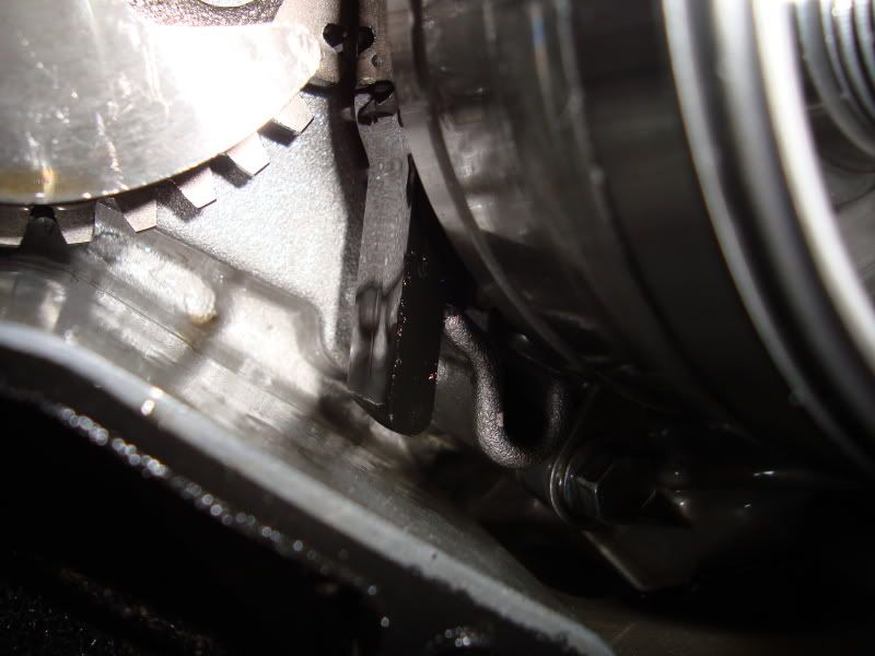

Well, I think I found part (or all) of the problem with my bike. The front chain guide is not engaged in its pocket! Hopefully the chatter goes away once this is fixed:
dcleball, have you ever heard chatter sound coming from the cam chain area? If so, maybe check to see if your guides are installed correctly?

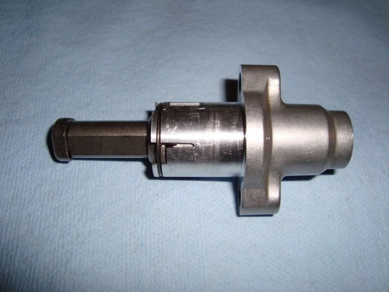

I've just had the same thing happen to my '06 KX250F.When I was inspecting it I noticed that the rod locking mechanism was nearly completely froze up I literally had to pry it back and forth with a screwdriver just to get it to lock and unlock.The spring was useless it didn't have enough pressure to keep it in the locked position.The only thing I could come up with is that maybe the pin that keeps it on there somehow got distorted or bent,because I can't even knock it out with a pin punch or anything else.I've tried almost everything to remove it and have exhausted all my resources,but one and that would probably destroy the whole darn thing.LOL Adynes You mentioned that you were gonna make a manual tension adjuster.That sounds like the route to go.Would you mind filling me in on how to "make"one or would this be an aftermarket part?Thanks.
Interesting story. So the guide was installed the wrong way - like not seated correctly? You said it ran OK one weekend, then bad on the next weekend at cold start. So do you think the cool down had something to do with? Sounds like you put it in wrong before those two practises but got away with OK running. Sounds like you are pretty lucky you did not mince your valves and head.

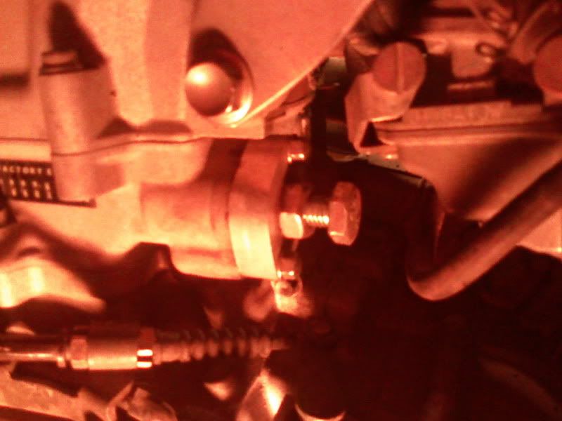

It sounds like your bike uses a different style tensioner.
Tokyo Mods makes a manual tensioner, $200 for the 450 and $120 for the 250, not sure of any others out there. I didn't take the time to get pictures of my manual tensioner before I installed it, but here it is after. I made it using a lathe, drill press, and disc sander, a 10mm bolt and jam nut:
I feel very confident I reinstalled the auto tensioner correctly the first time. I even made sure it had retracted fully with a small screwdriver, and the chain had no slack. I went ahead and made the manual tensioner, and installed it with no other changes. Same chain (probably original 06), and the guide is still not seated. I'll have to take the head off to fix that, so I'm going to wait till the snow flies.

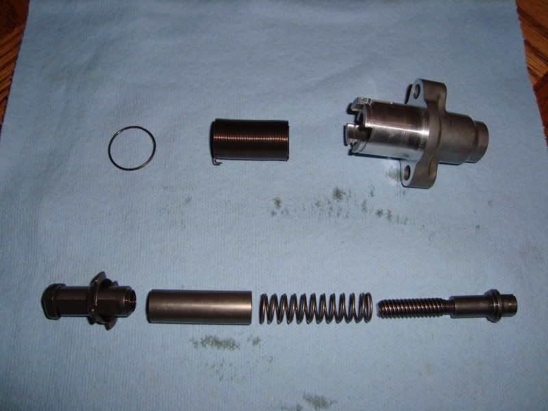

While I had the bike apart for the MCCT install, I checked to see just how much chain play is required to jump a tooth. I had to retract the auto tensioner (ACCT) fully, and even then it was just barely enough. I did some playing around with the the ACCT and found that if I twisted the plunger back and forth while it was loaded, it would in fact retract. I think that the ACCT is probably marignally sufficient when everything is new, but once the chain/tensioner starts to wear out, vibrations increase and it will eventually retract. My chain does have some resistance when you flex the links from and outside radius to an inside radius. I'm going to replace that this winter too.
The bike has run flawlessly for 3 practices now, probably about 10 hrs worth. The valvetrain noise has been GREATLY reduced, especially when cold, and at idle. I'm really happy about that. There is still a bit of noise at low rpm lugging conditions though. I'll let you guys know if any thing changes. :smirk:
Here's a pic of the ACCT disassembled:

Can you see any signs of wear on your ACCT?
Wondering if it looks fine, but works wrong (retracts all the way).

adynes you are correct my tensioner is a completely different style than yours.By looking at your homemade one gives me an idea on how I can make one.I have access to a small machine shop to fabricate the part.looks to be fairly easy thanks.Just to make sure I'm doing this right...........I guess when you start hearing valve noise would be the time you would want to manually tighten the tensioner,or should it be done after a certain amount of time(after so many hours).
No, not really.

Hard to say what kind of interval would be required. I'm going to recheck mine soon to see if it has moved at all. One thing I was real carefull with was making sure the end of the M10 bolt had a flat and polished face, so that it would not wear into the chain guide.
Would you simply check the chain tension by feel, when doing the valve clearance check, and adjust the manual tensioner if reqd?
Yeah, that's what I plan on doing. When I set the tension with the MCCT, I basically just tried to duplicate how I remembered it feeling with the ACCT by pressing down on the chain between the cams. I tried to err on the loose side. Hopefully it works out ok; so far, so good.
