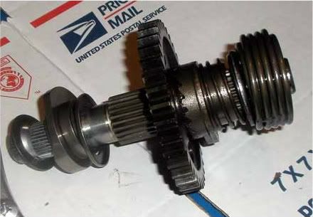

Question - Do the parts have to be from any specific year? I believe the manual is for 1993-2007 xr600 and xr650. I see a lot of kickstart assemblies on ebay for like 1987. Would this be applicable to my 1996XRL?

View PostAlex DeFreitas, on 16 March 2012 - 09:48 AM, said:
Mine was out of an '86 bottom end as well. It will work.

and a new countershaft?
  • ThumpNRed
Posted 20 March 2012 - 08:25 AM
Yes... You need an XR600R countershaft An xrl shaft will not work.

soooo countershaft (prob should buy new)
idler gear
kickstart lever
anything else?
