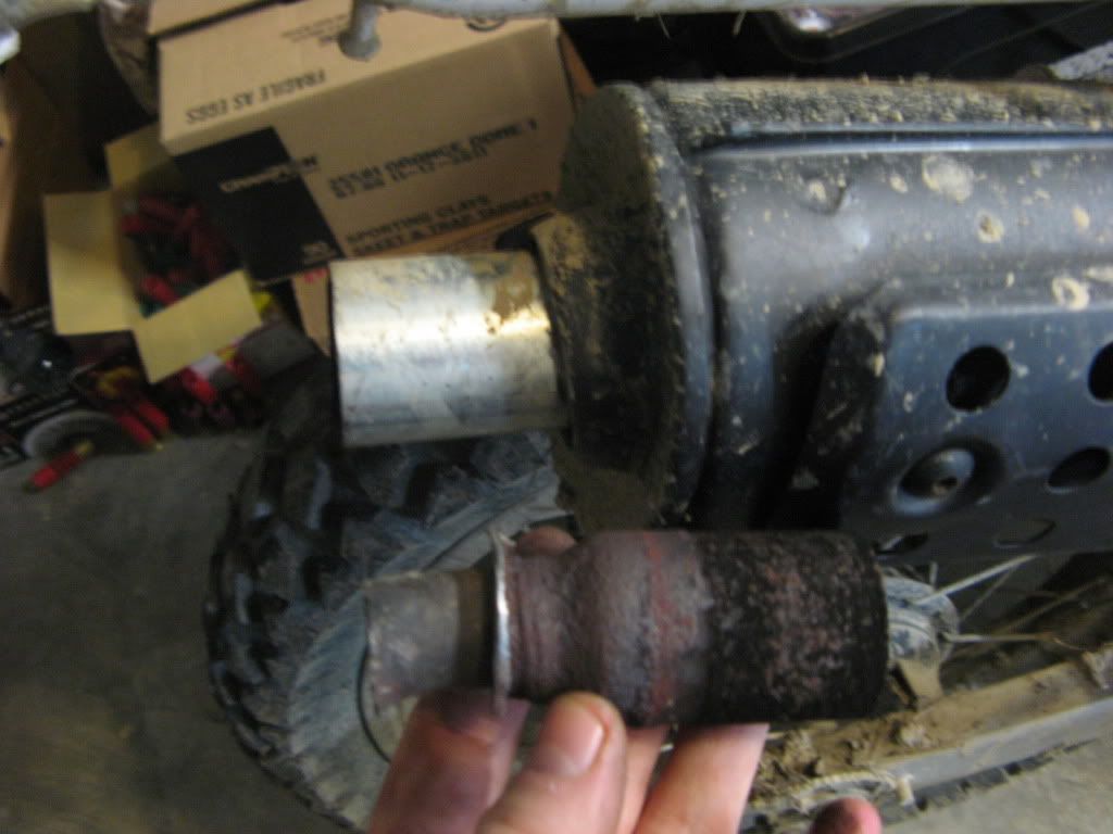

  • Cav1er
Posted 07 March 2012 - 08:41 PM
Reviving the dead, but whatever.
For a simple exhaust and intake upgrade=
Change main jet to 120
Take the Air box cover off.
Take a 1 1/2" hole saw, and drill into the end of the muffler, until an entire section of pipe comes out- It looks like a reducer from 1 1/2" to about 3/4"-See Pic
Take 4" of 1 1/2" conduit, and weld it into the end of the muffler with about 1 1/2" sticking out.
Gives the bike a much throatier sound, and a little power increase.
