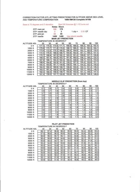

3.) The jets that came from the factory are 175 (main) and 55 (pilot). According to this thumpertalk thread:
http://www.thumperta...65&postcount=24
...and this chart (from the same thread)
Depending on your altitude and how hot it is outside, the main jet (175) was too rich from the factory.

Ok, onwards to my tuning:
Since I've been riding at 50-70 degree F at approximately zero degree elevation, the chart says I should roughly have a:
-170 main jet
-155 pilot jet
-stock needle, 3rd position
-the air screw 1.5 turns out
I pulled the carb, made sure the passageways were clear, installed new jets (so I know they weren't clogged), and surprisingly...the bike still doesn't idle.
The idle works like this: the slide is all the way down, so gas predominantly comes through the pilot jet. Air comes from a small, 1/4" tunnel that goes around the slide and connects the intake side to the air box side. By turning the idle adjust screw, you regulate the size of the opening of that tunnel. The bigger the opening of that tunnel, the more air comes through, and mixes with gas from the pilot.
Any ideas?
