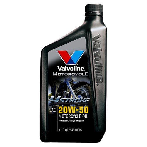

My last two oil changes I used Motul 300v full esther synthetic changed at 1000 mile intervals but I notice the shifting is a bit more notchy than when I use the cheap Valvoline 20w-50 4-stroke motorcycle oil from AutoZone. And at $50 a gallon that blows! I think I'm going to go back to the Valvoline and 500 mile change intervals. Even though I'll be changing the oil twice as often it will still be cheaper than the Motul.

AND...
I second the vote for Valvoline 20-50 4-stroke.
I've already had 3 different oils in my bike... and without a doubt... the Valvoline 20-50 is the smoothest shifting of the ones I've used. Since I bought my bike with a bad trans... and I had the indexer stick... smooth shifting is what I was looking for.
