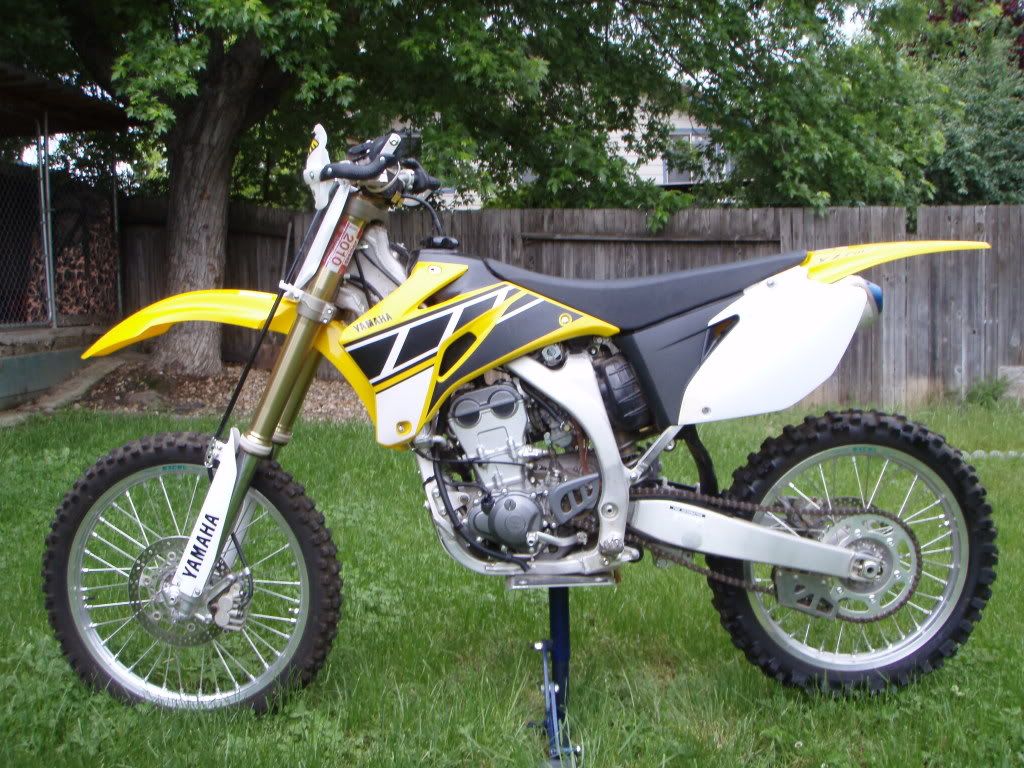

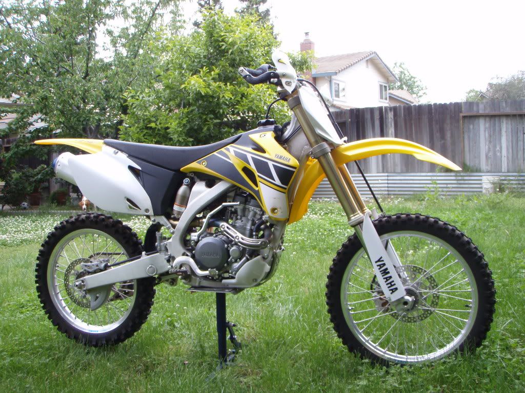

Bike: 2006 YZ250F 50th Anniversary Edition.
Mods: Handguards. Plastics, graphics, and tires are in the mail.
Issue: Bogging
I bought the bike a couple months ago.  It was brand spanking new. Maybe 5 hrs on it, if that.  I rode it in my neighborhood a bit, but not on the track/trails.  Still havent ridden it properly(waiting on new tires and graphics).
I did some searching, but cant find an exact answer for my area. The bike has quite a bit of bog down low.  I want to get rid of it, but dont exactly know what to do.
I read that a #40 leak jet would help and the o ring mod.  But does that work for all areas and elevations?
Im riding in the Sacramento Valley, so its pretty much sea level.
Thanks
