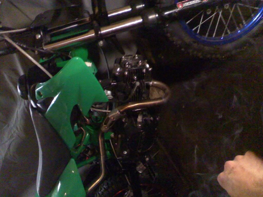

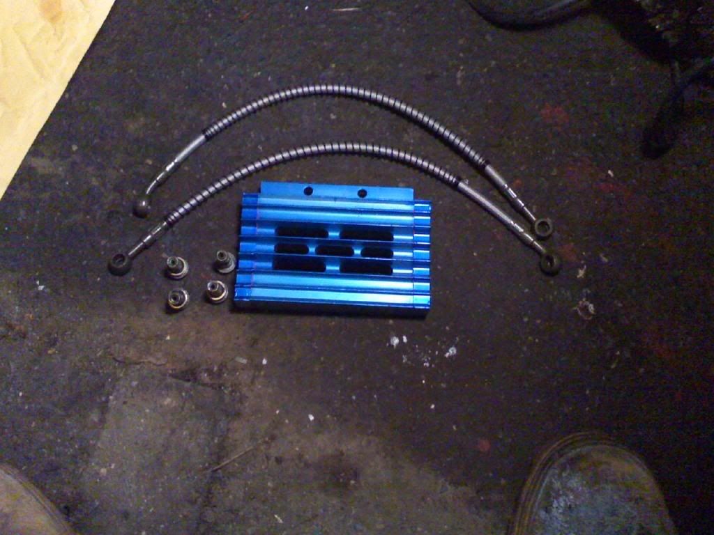

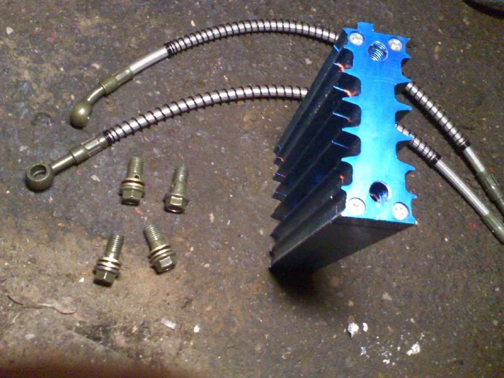

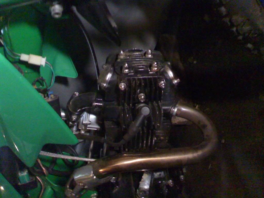

well just like the title says i bought an oil cooler for my pit bike but no instructions came with it. i have a lifan 125cc start neutral engine. i know i have to drill and tap lines but where. if anyone have detailed instructions that would be helpful.

we need more info. what oilcooler and what bike??? maybe post some pics so we can help out.

first off none of the oil cooler kits we sell require drilling
most 125 pitbike oil cooler come off the head with a bolt on plate
  • staggsracing
Posted 19 June 2009 - 07:22 PM
Or Into The Case Of The Motor

not bad for a camera phone HUH? but yea that's what i have to work with.its more of a cheaper one i just bought but they if it works sweet deal. i only bought two bikes for 50 bucks pieced them together to make one cool bike  if you need more pics let me know its 6 am long night and last thing before bed.

you need a oil head plate that taped 10mm
http://tboltusa.com/...products_id=695
we have them in stock in silver/aluminum and others in billet red

your going to run into another problem your going to have to make some kind of bracket to hold it also as it doesn't look like your frame has one?

no way man its all good. why buy it, ill make both tbolt usa  makes em so can i and a bracket is no problem its just how far way and where i can put it, but i like the fact i don't have a bracket just that much more different from your bike. but thank you now i know where to drill the holes.
