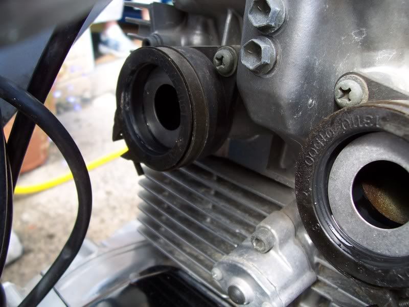

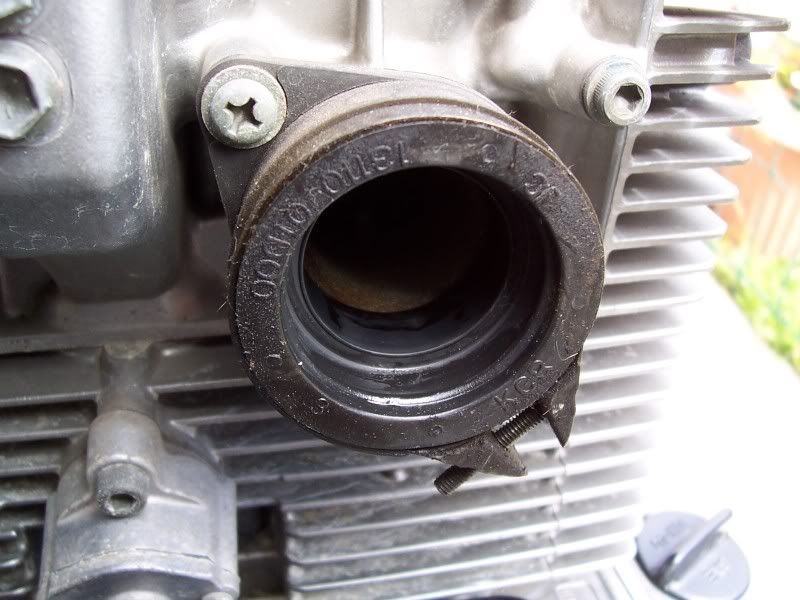

Might also be a large washer in the inlet rubber between the carb and cylinder head.I bought a GS500 twin some years ago to commute on,pretty gutless but turns out it was restricted to 33HP with these 2 washers!Cheers

I think they are restricted with the washes in the intake as in the previous post pictures, but they only fit them if requested don’t they????
