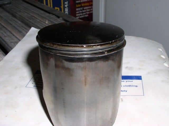

When I started pulling the topend apart, oil started flowing. There was quite alot of oil in the exhaust valve area to the point of saturating the gaskets for the covers. I pulled the jug and cleaned everything out, honed it with the brush :p
There was a scratch inside the cylinder and a matching one on the piston. nothing serious, but probably a piece of dirt and it did hone out. The piston doesn't look like it has 30hrs on it at all. Almost no scuffing or wear and it could have gone another 30. I'll take a pic of it when the camera gets here.

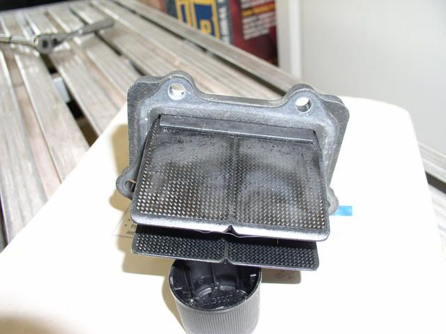

One thing I did notice when I pulled the V-force off is that the top of the reeds on the upper half were all chalkie. I don't think I will be installing it back on because it scares me. I found the same kind of black chalk like material on the inside of the intake manifold area. I'll take a pic of that as well. The wrist pin was difficult to remove, like it was stuck. I got it out without too much trouble and found that it was somewhat discolored. Interesting to say the least.

Didn't you know that V-force is actually V-farce meaning they're a farce to be reckoned with? Seriously though, they're junk. Get a Boyesen Rad Valve or some OEMs or some Boyesen super stocker's (not stalker :p).

I actually think it may be a material flaw or something. The rest of the reeds look alright. I threw the stock cage back into it for now.

The reeds! notice the discoloration/film that is on them and only on the top reeds.
Does this piston look like it has 30hrs on it? I could have just replace the rings and been good.

That looks an awful lot like Reddi-wip residue on the reeds. A dollop of Silkolene should take care of it. :p
I'd clean that piston up and hold it back as a spare.

I agree on all 3 accounts.
I just find it weird that the reeds would look like that.
