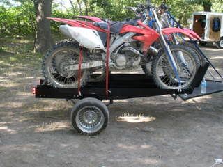

I took a PWC trailer and converted it to a 3 place bike hauler. It came out really nice, I will have to take a picture one of these days and post it up.
I got the trailer free from a marina (it didn't have a title and I am the owners sons godfather so that always helps). My dad runs a steel center so I got all the metal at cost. A friend of mine runs a sheet metal fab shop and he was able to fab the bike rails, fenders and powerder coat everything black, including the frame. I also found a set of 14" 100 spoke rims for free so it made the trailer look different. all said and done I think i paid around 100 for material and I can't remember what it cost to file for a lost title.
I usually have 2 450's and a 125 on it or 2 450's and 2 50's and it works perfect.

  • Jbeaz
Posted January 21, 2009 - 09:00 AM
Here we go, first attempt at posting a picture. This is from early this summer before it was completed. The fenders were fab'd after this picture and the lights were relocated to the back of the fenders. Also, the tie downs were moved so that the bikes were more stable and now only need the straps on the handle bars holding them down.

S W E E T R I M S ! ! :banana: :lol: :lol: :lol:
