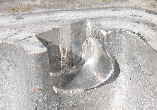

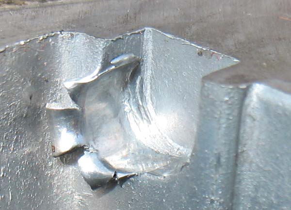

  • AntonLargiader
Posted 02 February 2012 - 08:30 AM
Here are some shots of the worn parts. I'd like some feedback as to how normal this is, and whether or not I should just reassemble with a new guide.
The guide
Left side support
Right side support:
  • Old School Al
Posted 02 February 2012 - 10:55 AM
A sign of a badly neglected 200! When there is a noise........... there is a problem! Don't use that cyl, get another one. Always want to check that area of the cyl when looking for a used one.
