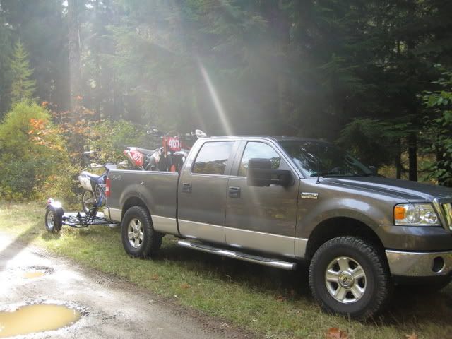

  • eplanajr
Posted 29 October 2008 - 01:11 PM
2007 F150 4x4
35" BFG AT KO's (315/70/17 on stock wheels)
Bilstien 5100's front and rear, fronts are set at 2" Preload
