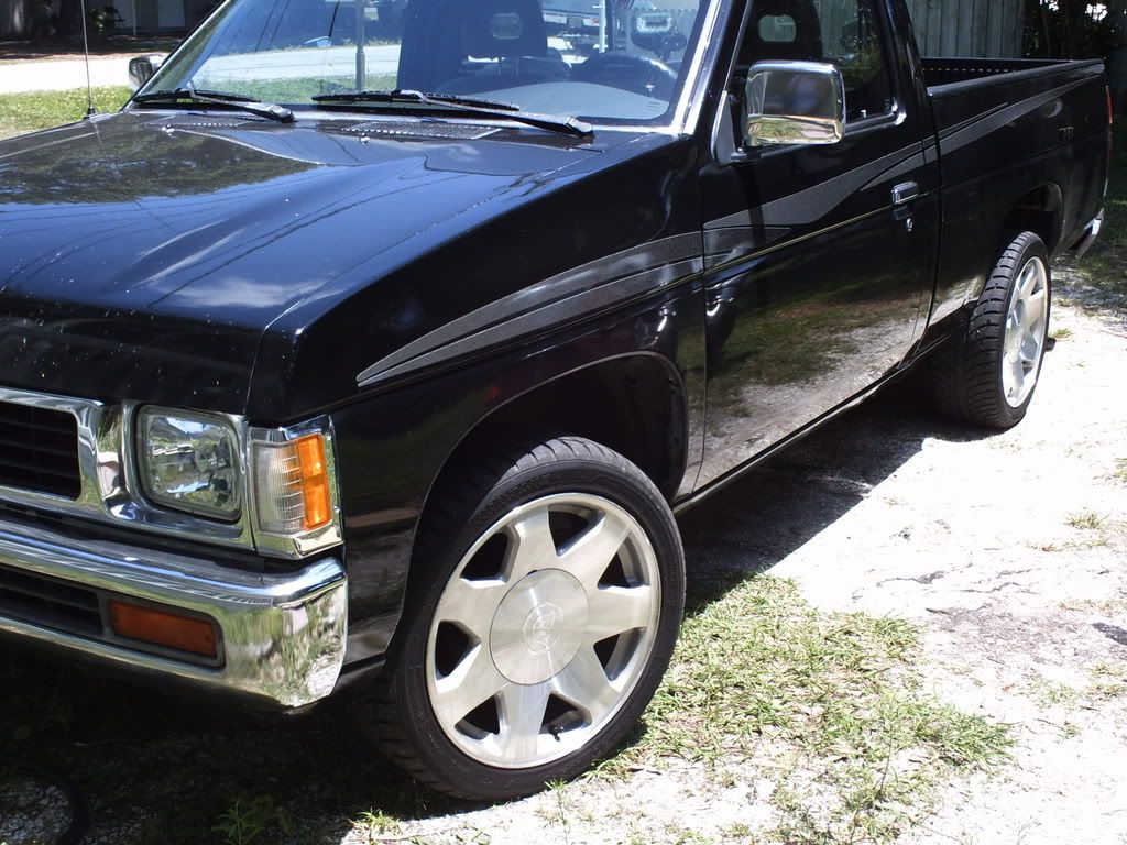

  • hometheaterman
Posted October 03, 2008 - 06:53 AM

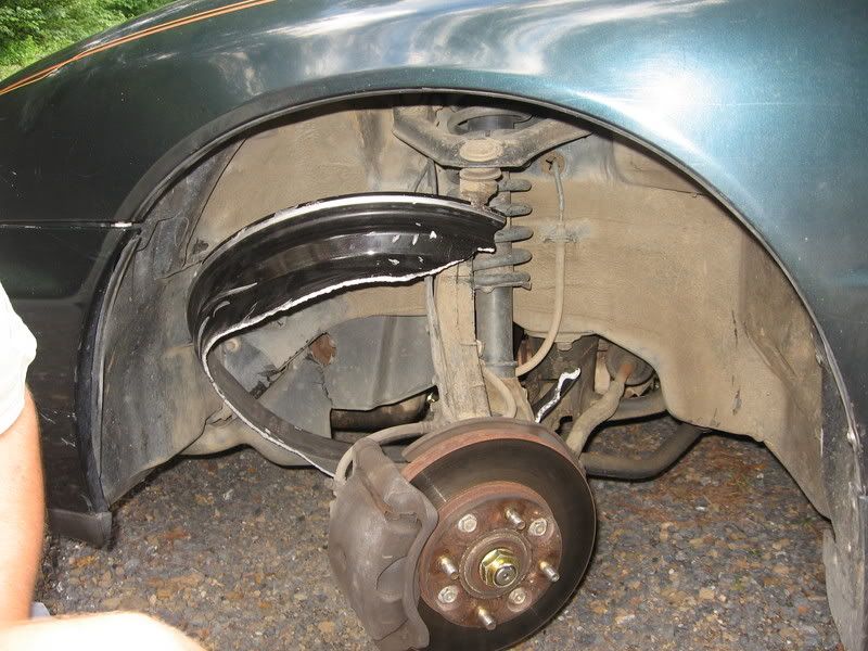

I had 18" wheels with low profile tires probably a lot more low profile than those in that picture. At least they appeared to be. I had them for about a week until I hit a bad pot hole and it broke both of the wheels on that side that hit it. With such a thin tire it had no tire to absorb the impact of the pot hole so the wheel took it all. I highly doubt it would have done much damage had I had normal tires on there. The front wheel split in half and the rear one just cracked but didn't come apart. Honestly the wheels looked great but since they broke from hitting a pot hole so easily it kind of turned me away from low profile tires. After telling people about it I found out this is a common thing with low profile tires and big wheels.

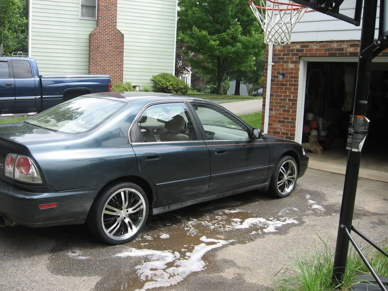

Here is what the car looked like when I put the wheels on
Posted ImageI couldn't get over how much I liked the look.

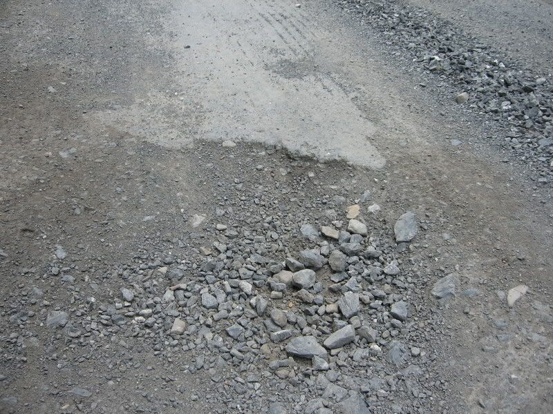

Here is what I hit. It's a little deaper than it looks and kind of has that lip of asphalt.
Here is the back half of the wheel that got stuck in the car. We had a time getting it out. Finally we got it pried out with the tire iron that came with the car. It was two of us trying to get this thing out.
Front of the wheel

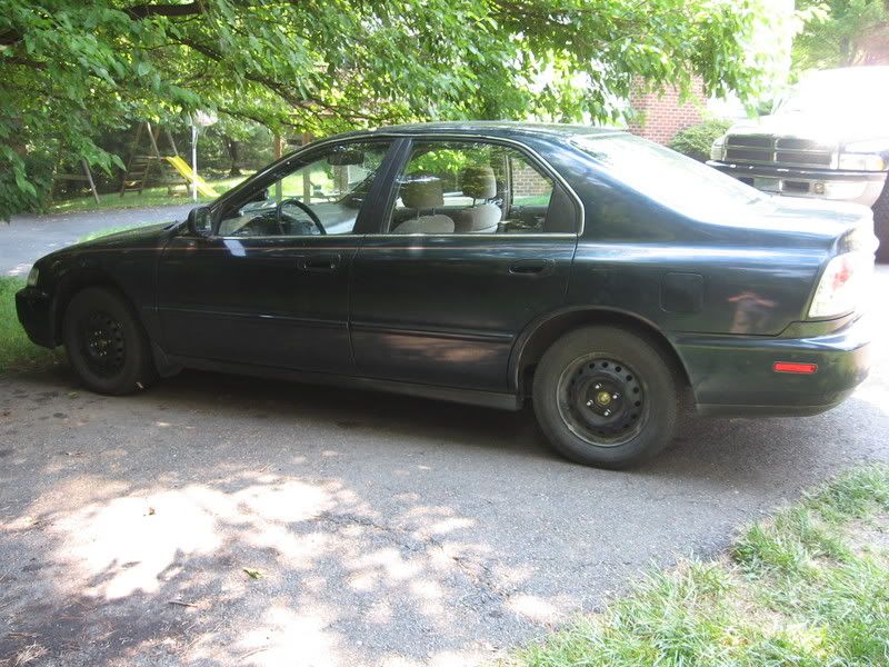

The wheels I had to borrow from my buddy that was riding with me to drive home on. These were off his 91 Accord he had just purchased. Hadn't even picked it up yet and we had to go get the wheels off of it.
I lucked out as I was in an area where my phone said no signal well no bars but it let the call go through to get someone to come pick us up. Then I also lucked out as the guy with me had just bought that 91 Accord and let me borrow his wheels to get the car home. I had the stock wheels at home so I just put them back on when I got home.
