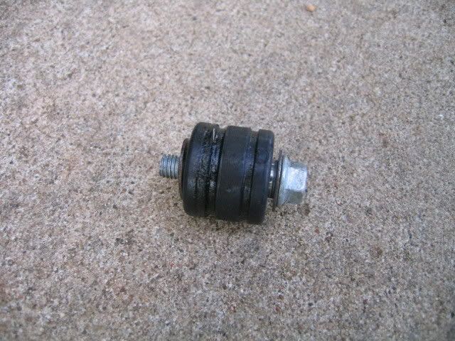

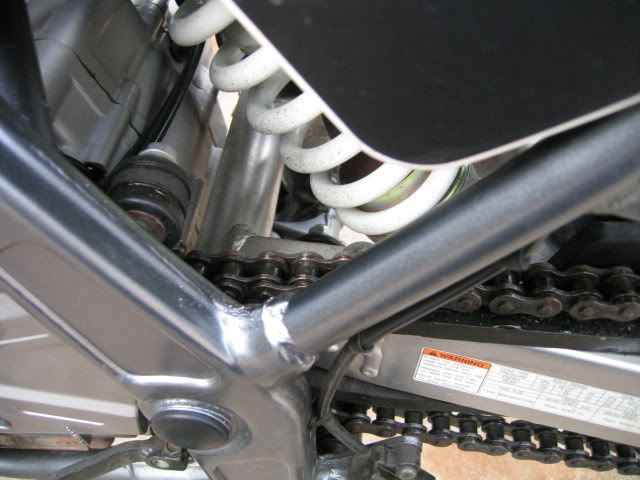

Success! The whole procedure took about 3 minutes to accomplish. I used a 12mm socket, and it came right off. It is strange that Suzuki would place this roller up so high. I mean, it is nowhere near the chain to begin with, and I can see how the chain slapping it would cause it to shoot off.
Before the operation!
Chain Roller Removed!
Drive Chain minus Upper Chain Roller! (will use silicone or 8mm x 1.25" screw to cover hole)

The actual problem is that it's not high enough. When the suspension compresses the chain contacts the roller (hence those two huge grooves in your roller :thumbsup: ), puts it under tremedous pressure and promptly rips it out of the frame. Engineer-san must have had his slide rule on the wrong setting the day they designed that.
  • adams
Posted September 03, 2008 - 09:57 AM
those are some very big grooves in the roller, when I removed the rollers on my bike they were untouched

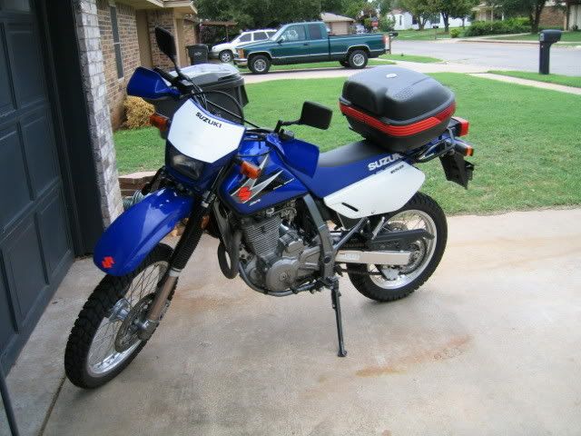

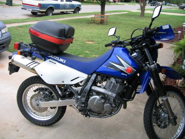

I guess it was good I removed it when I did! I also just installed a Rear Rack with a trunk.
Before pic
After pic
Another pic w/trunk

Wow! I've never seen that rack mounted backwards before. Is it only held onto the mounts with two screws?

One word of note, WHen you put a screw in the roller hole, make sure you use a set screw. (a screw without a head). casue if there is anything there to catch the chain it will! And locktite it in there so that it doesn't work its way out.
Believe it or not, I tried it both ways. This way, my back can rest on that backrest that is on the trunk (the other way, the trunk was too far back). I only do solo riding, so this isn't bad at all. It is actually quite comfortable having that pad to lean back on (although the riding position is quite forward!).
The rack is held up with 3 screws actually (the center screw and the left/right sides). It is quite sturdy. I kept the other two screws in case I decide to revert back.
