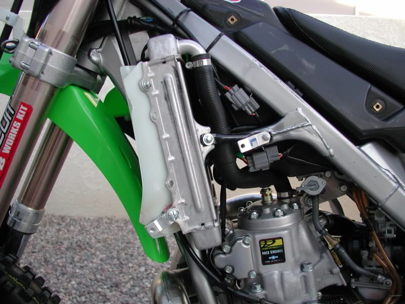

Bored of the plastics that are unchanged since 2003?
while I bouhgt YZF shrouds for my YZ250 and discovered that it's almost impossible to make them fit it's rather easy to make the KXF shrouds fit a 2-stroke KX250. I bought KX250F shrouds, KX450F shrouds have a different part number but I don't know what is the difference between those two.
the only things I needed were 3 brackets each side and just a little cutting of the plastics.
if you want more information/pictures - let me know :thumbsup:

That looks good sitting, but I think you are going to impale your knee on that corner when riding!

Ya looks like a boot will hang right up in there A!

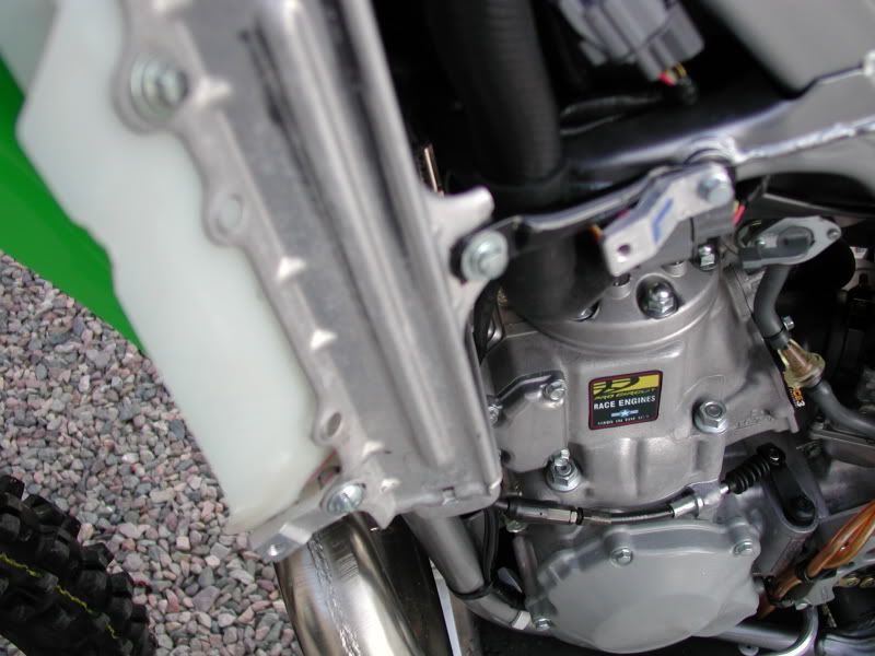

here we go!
first of all, a very special non photoshopped extra release for some friends here:
http://www.supercros...de/DSCF5179.JPG
here are the brackets:

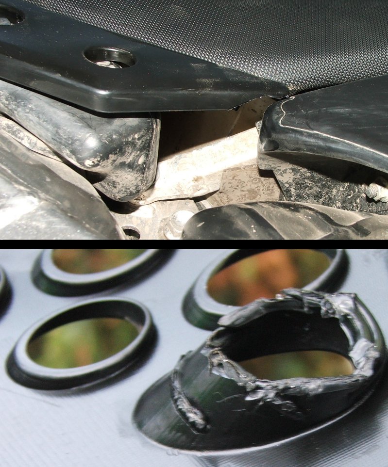

for the right side I took the pipe mounting (because I bolt on a YZ pipe which didn't need the upper mounting point, left I used the radiator reinforcing bar
the upper mounting holes of both shrouds are cut like you can see in the picture, also the left one is cut where it touches the air filter box:
