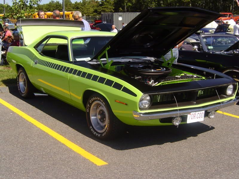

I do not believe it will fit under to work on our Pit Bikes....as I have one that looks just like it I use to tune Preformance Six pack Carbs on this Bad Boy
it may work if the bend is under 1 inch
