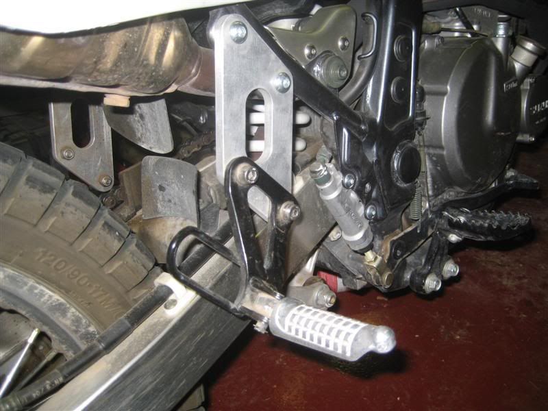

  • Runamuk
Posted July 22, 2008 - 04:08 PM
I just installed these.
Muk

  • XPLRN
Posted July 22, 2008 - 09:44 PM
Muk
Who installed those!???:thumbsup: :bonk: :thumbsup:
They seem to be multiplying.........well I actually turned Rick on to those brackets. The story on how they came into my possession was thru an older friend of mine. The gentleman was/is a hardcore riding enthusiast and talked me into buying a 2000 DR650.........as he'd just bought one and absolutely loved it. He has problems with his knees and back and thought having a place to re-position his feet would help with his knee/back/butt issues. The problem was the rear passenger pegs were too high in the stock location for him to rest his feet on without totally messing up his knees and back. He came up with the drop bracket idea and a local friend of ours did the design/fab work to make them a reality. He couldn't say enough good things about how the drop brackets saved his knees, back and butt after he did his first long dual sport ride with them on. I ended up getting some of them also and can echo his thoughts about the benefit/difference they make.....just easier on the knees and butt in my situation......luckily my back is still good.
The ability to move your feet almost directly backwards and slightly up allows you to rotate your pelvic which changes your butt contact with the seat and takes some of the direct pressure off your butt. On long dual sport rides it does make a difference!! Heck even around town I find Myself putting my feet back there to change my seating stance.
Sooo anyways that's a bunch of :thumbsup: :thumbsup: :bonk: about that. If anyone is interested in purchasing them PM me your personal e-mail/contact info and I'll get you the contact info for the local guy that makes them up.
  • Runamuk
Posted July 22, 2008 - 10:21 PM
All this time I thought they were just comfortable and gave my pillion some leg room as an added bonus.
Mine still look better in black:p
Muk
  • XPLRN
Posted July 23, 2008 - 04:34 AM
Muk
All this time..............do some more :thumbsup: miles and you'll really start to appreciate!! Yes, I do have to agree that yours do look better in black!! That's on the short list; do the Muk spray-on bedliner material coating to my set!! I'm going to do everything except the folding silver footpeg.

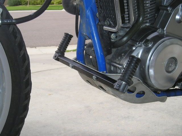

  • DoubleD650
Posted July 24, 2008 - 05:03 AM
I put some last minute china pegs on the skidplate...
And I was soooooo glad on that long hallllll.....
Just to change the foot/ass position adds miles ;)
See 'em ding-ing off the front there... 2 holes. $20 pegs,,$1.50 in washers..
Was setup to be removable-Post Trip,,,,,:ride:

  • DoubleD650
Posted July 25, 2008 - 06:51 AM
What skid plate ,,,
Less see here;
utah sports skid plate,,, the one with the wings,,,,

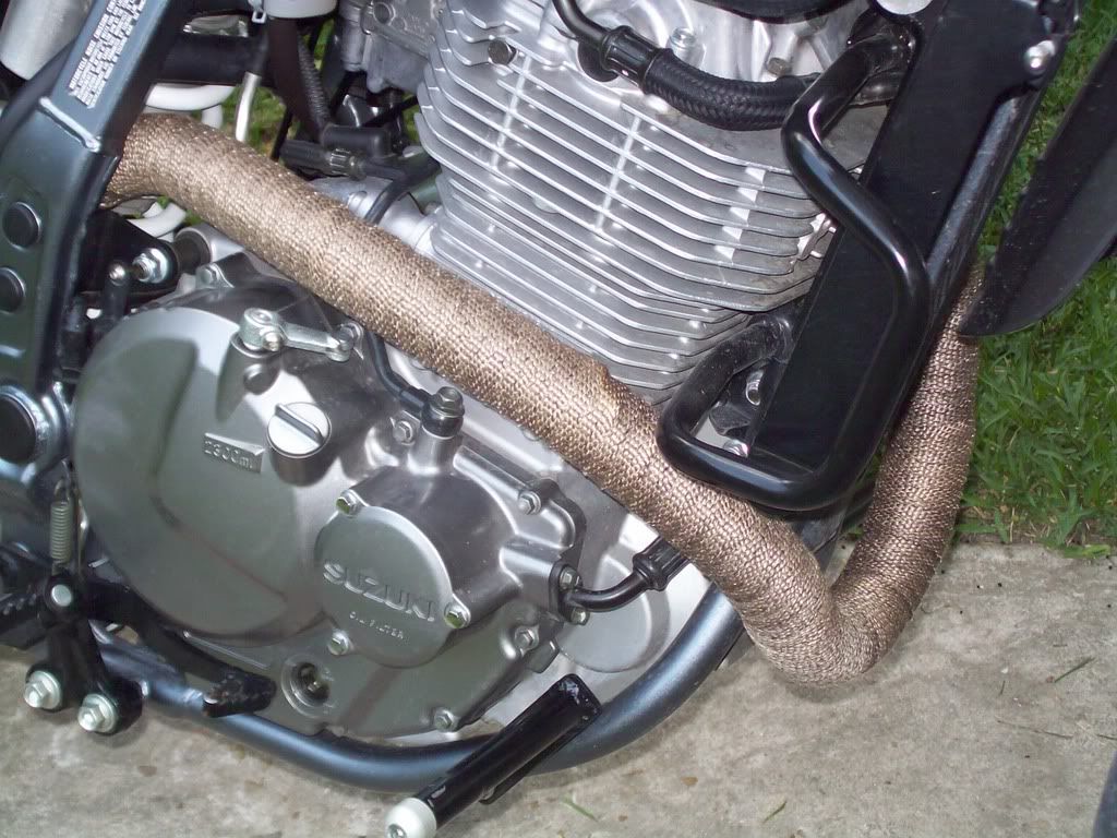

  • firemedic1295
Posted July 26, 2008 - 02:04 PM
Cheeseburger,
Here's what I came up with on my 95 DR.
Square stock, old pegs lying around, a little drilling & welding...wa-lah!
Simple & cheep, but very effective on the old hip joint!
