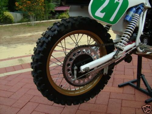

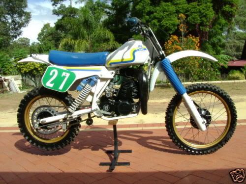

pics lifted from ebay! Here ya go!
83 250 XC   note rear frame loop over rear fender.... common to WR and XC ( not CR) Also note solid mount brake stay arm going to weld tab under swingarm.
Brake backer plate XC style ( note that on your red frame bike you have a CR style mated with and XC frame) The CR used a floating brake backer plate and brake stay. The XC used a soild mounted brake stay arm that tucked up into a bracket welded under the swingarm

nice bike HuskyT and thanks for the pic, am still ringing around to get quotes on parts needed.
