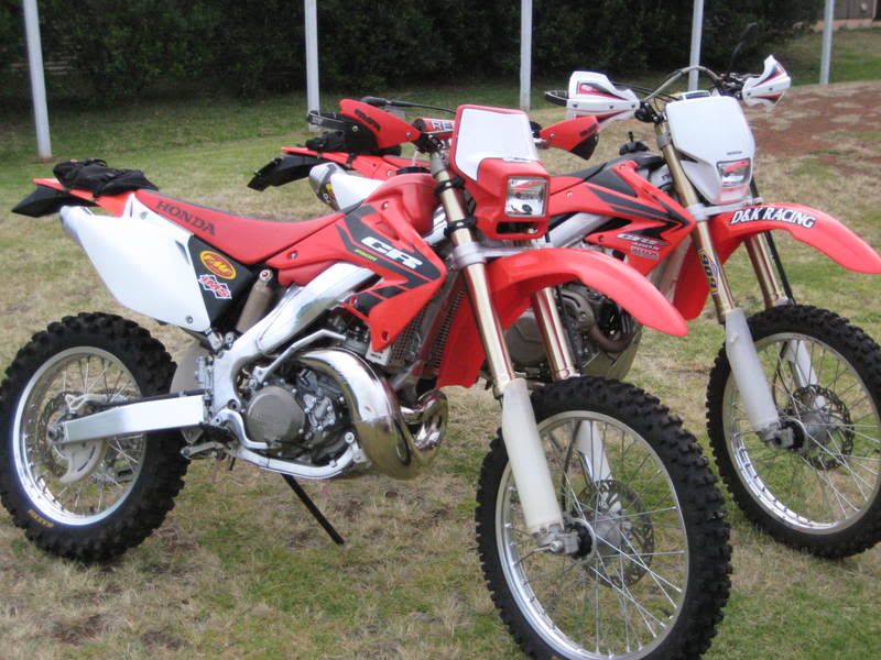

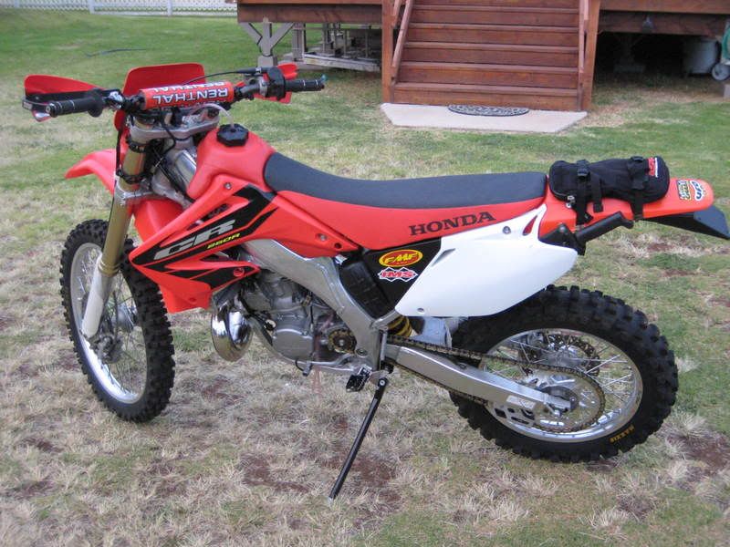

I Have a Baja kit on my 03 250, its a decent set up, you could probably find a better or even a cheaper set up but this was an easy plug and ride unit.
  • fozjared
Posted 26 March 2008 - 09:18 PM
awesome bike there man! love the machete placement, looks sharp!
  • shrubitup
Posted 26 March 2008 - 09:43 PM
Damn you know how to keep a bike clean!!!:prof:
  • moto9
Posted 27 March 2008 - 01:10 AM
Sorry...the only reason the bike is clean is because I just bought it off some one who built it for trail riding and never used it, that's why I took some pics before I get it in the trails, it's clean no more!!
