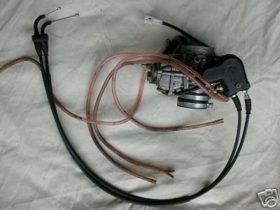

I have a '03 400S and I'm looking into changing the carb out. It seems every one is happy with the Keihin 39mm FCR.
My question to those that have done this conversion is it worth just buying it from tt store or piece it together and try to save some bucks. I think that buying it from tt might be more expensive, but then won't have the head ache of trying to track down parts. Any sugestions welcomed.

I didn't get the TT carb, I acquired a used carb from an E. I wish I would've got the TT carb & here's why; it took a few weeks of gathering bits-N-pieces, scouring 'FCR' threads, & trial & error to get it to fit. The bits-N-pieces added up quick. I also had to buy E model throttle cables. The float bowl gasket was pinched & leaked, so I had to order another.
Looking back, I'd definitely get the FCR MX from TT.

I lucked out and got a 39fcr off of ebay for 200.00 It came off of a drz400e model and it had the jd jet kit in it, and the guy gave me the airbox boot,throttle cables and spare jets. I had it installed by my mechanic and it was not much in labor either. The bike rips and i have no problems to speak of. I have the 440kit, hot cams, fmf powerbomb w/Q2, 3x3, twin-air filter. The carb was the last thing i did and man it really woke the bike up, i was shocked by how much of a difference a carb can make! I guess i am one of the lucky ones that got one off ebay and had no problems. The way im looking at it is i saved like 300.00 and change from buying new and having it installed.

I just brought one off Ebay. I was going to purchase a TT kit in the neer future but this came up for £65 including p+p. Its actually off a KTM so I know its going to need all the extra bits and pieces but I work for suzuki so I can get E model parts easily and cheaper.
I beleive that these carbs are all the same except the addapters etc so I presume with the right bits this will work fine. If I'm wrong then please let me know.
I couldn't pass this opportunity and thought if all else fails I could probably sell it for more than I brought it.
I will let you know hoe it all goes.. for now at least I have a big smile on my face :thumbsup:
as long as it has the removable intake bell it should work fine.the throttle wheel assembly will contact the frame so you do have to tilt the carb

I bought a used FCR off of ebay and after using it with an EMN needle and jetting noticed higher fuel consumption. I thought the thing was a piece of crap(the FCR). Eddie told me to get the EMP needle and the main jet holder. After fooling with the Taffy mod, new throttle plate and another round of jetting and all the gaskets, the carb is finally sorted(runs good). Haven't done a fuel mileage check, but it rips. Finicky piece if you ask me, but definetly more power. Order from TT, the price I have into this and all the screwing around, it is worth the 500 from the TT store. The used ones are prone to wearing out, I got somewhat lucky and mine hasn't ended up on the garage floor, but it was close. Good Luck if you go on Ebay, you will need it. :thumbsup: vanram
