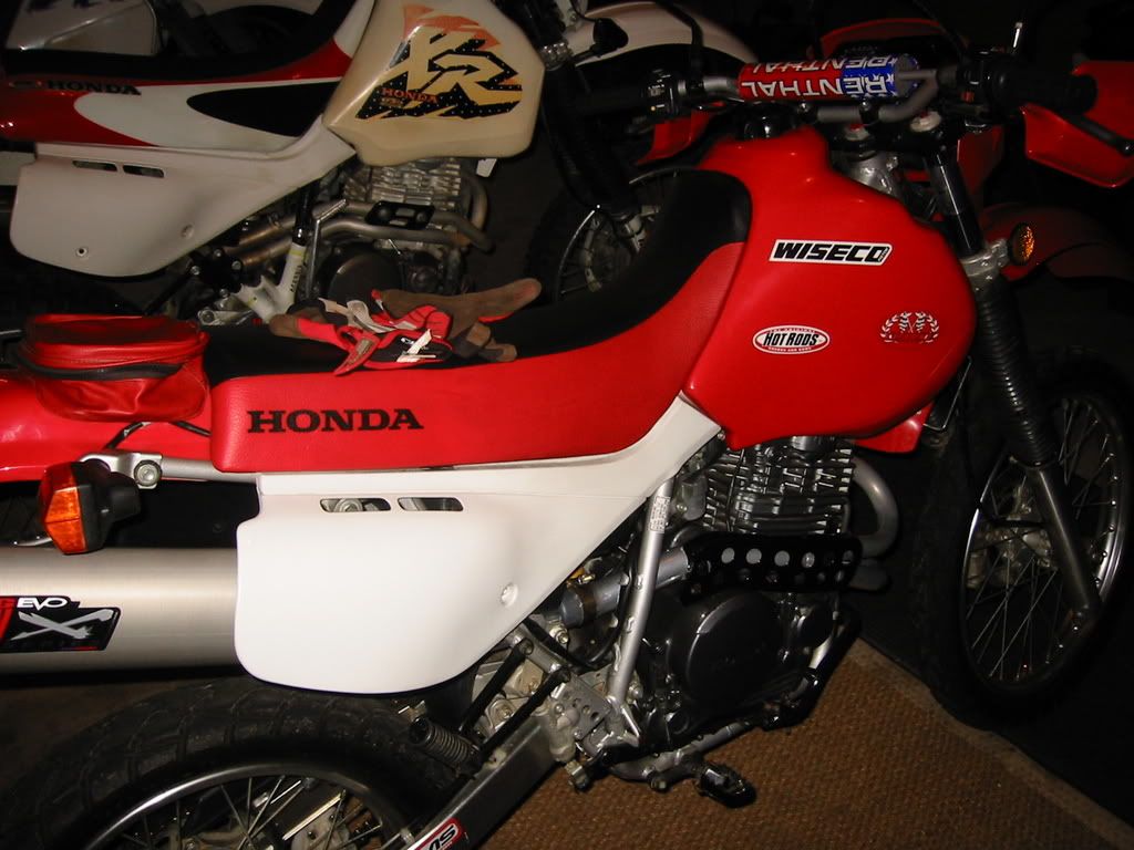

Congrats on your new L James! You are going to have so much fun riding and modding the pig. are you sure you want 5.8 gal? Thats alot of fuel weight, and they are a real BITCH to fit the bike. I have a Clarke 4.0 and its goo for 140 miles with res. I have 2" pivoting risers and CR hi bend bars (Im 6'5") and its perfect. No need for longer cables with my setup, yours, I cant say. The best thing would be to have your shock and forks resprung for your weight. Heres a few pics of my setup. The box of stuff weighs close to 25 pounds by now! XR400 front fender gets rid of that droop. I also have a crf 450 rear. Just let me know if any questions!
