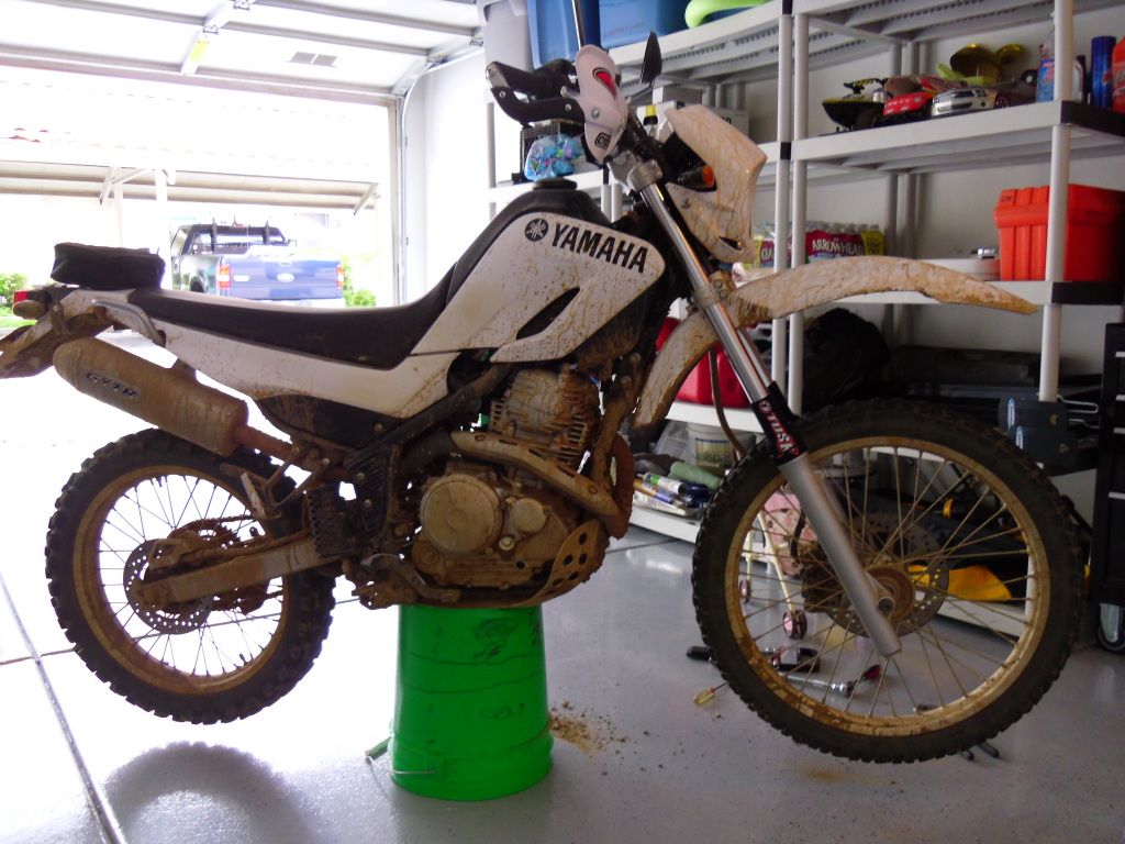

Added some tusk goodies to the xt,  from rockymountain.com
tusk rear fender pack
Tusk seal savers
the bag is 14 bucks and the seal gurads are 10 bucks,  so not bad for only 25 bucks,  quality is great on both
