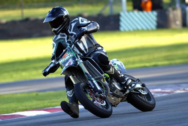

  • headster
Posted January 19, 2008 - 10:31 AM
This was taken at Brands Hatch on the final corner.
I was leant over as far as i felt comfortable with, and was no where near peg down!
The bike will go well past pegs down and still stay up, its all in your head tho. Trust me i know!

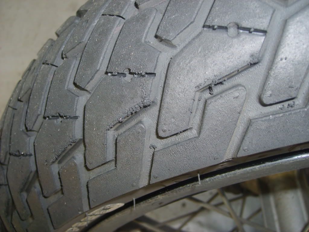

  • headster
Posted January 19, 2008 - 10:32 AM
oh and heres the wear on the rear tire, no where near the edges!!

  • headster
Posted January 19, 2008 - 11:36 AM
tyres are Maxxis Street Sports, and are perfect!
Run them on the road for 3 months now, and love them to bits!

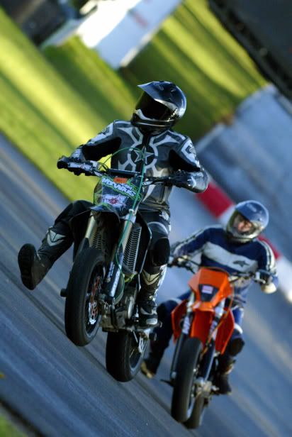

  • nadrojp
Posted January 19, 2008 - 11:50 AM
heres an old pic of my first trackday out... w/ my foot kind of in like a dirt tracker. I ride much better now, but you get the picture as far as a decent lean(peg barely touching)
looking good and it looks like a confident way of doing it, but as headster says it maybe better leaning like a sports bike round fast corners

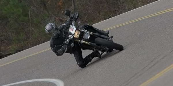

  • 421Slicer
Posted January 19, 2008 - 06:49 PM
I can knee down very easily on my zx6 (when i had it) but dont feel as safe on my sm cornering as it feels really light on the back end. anyone got any pics of themselfs leaning an sm to its maximum?
Not It's Maximum... That's be dragging pegs (yeah I've done it!)
...even with a rain tire! I had to hang off more though!
Note that hanging off will reduce the lean angle of the bike, while increasing corner ability! These pics, I was going between 45 and 50 mph. In the sub 30 turns, I tend to stick a foot out, and slam the pegs down... If it walks, my boot's ready!
