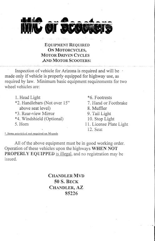

Posted 11 April 2008 - 07:47 AM
Nothing about horns?  I'm not sure I trust that chart's usefulness.  Here's a sheet I got from my local AZ MVD office.

yeah I want to legalize my DRZ400e in michigan, does anyone have ALL the requirements for it like that sheet HawkGT put on for Arizona...the PDF file from the MSF on here doesn't tell all the requirements...it doesn't mention horn, headlight, taillight..or stoplight.
I think in Az it also depends where you live. Here in Prescott I took my cr500 in for an inspection for a registraion, and after checking the numbers, the lady asked me if I wanted a street liscence or a dirt licsense. I asked what it would take to make it street licsensed and she said "nothing, it's up to you to make it road worthy, but we will give you a street plate right now if you want it.":eek:
